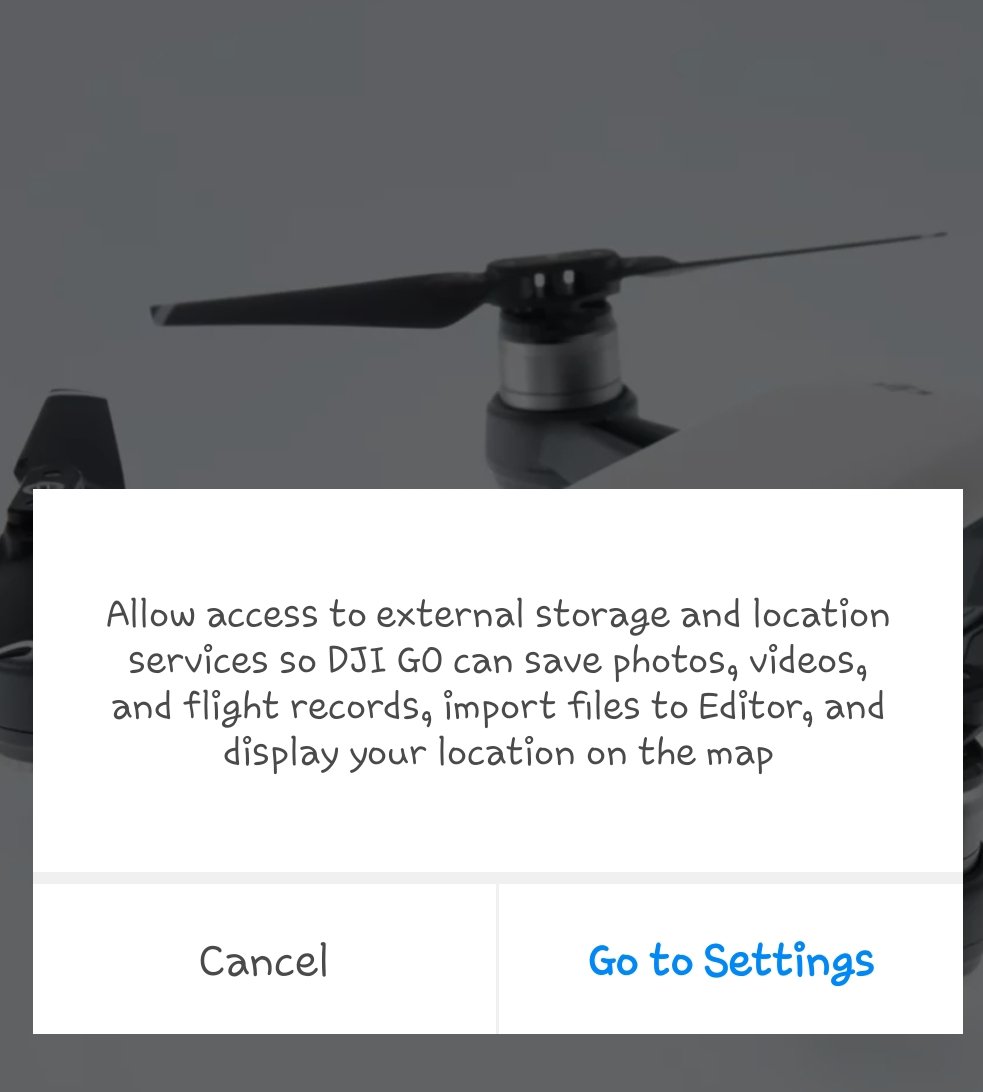

I use either my phone (android 11) or tablet (android 12) to fly P3SE with DJI GO. Suddenly, after months of normal flying, the tablet DJI GO app started refusing to load, complaining about access to external storage and location - I've checked the settings, all of it is allowed (camera and microphone are not, since DJI GO has no business filming or listening ;) ). At the same time phone version of DJI GO is working perfectly fine.
What's up with that ?
Thanks :)View attachment IMG_20230722_114509_1.jpg

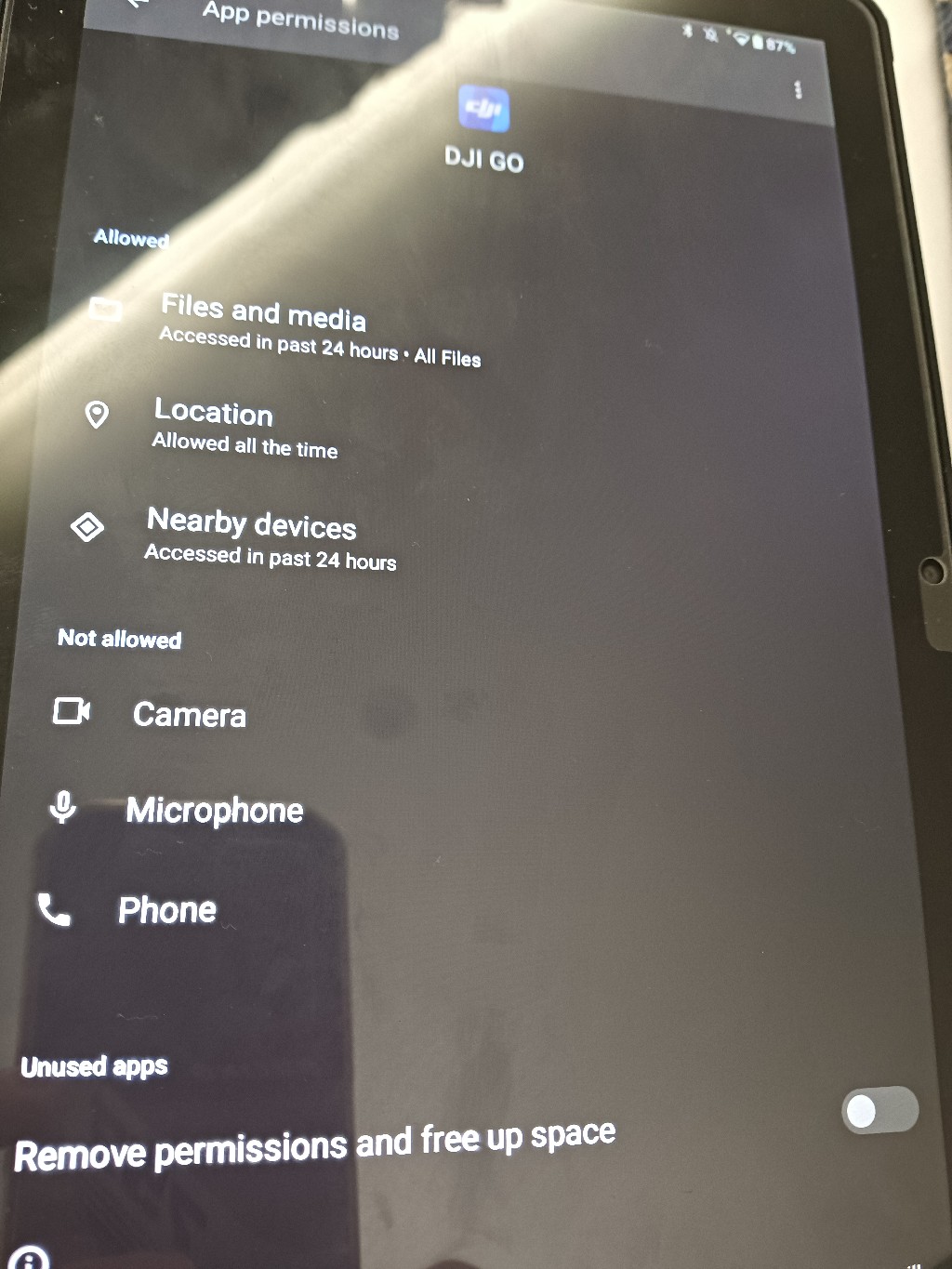

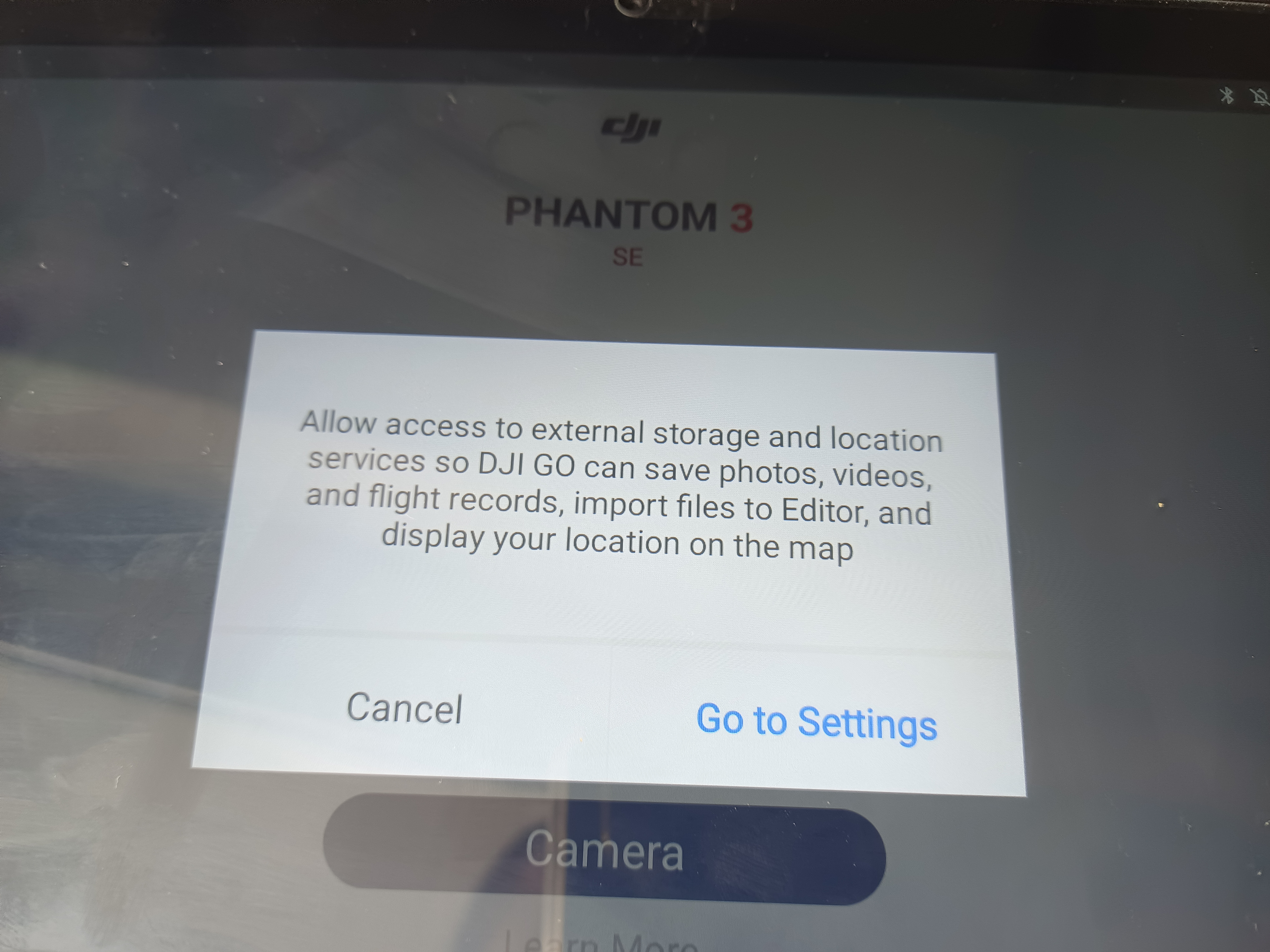

that's the problem - they are all enabled. It worked one day, stopped working the next day. On tablet. Works fine on phone.

Im having the exact same issue. Works fine on my phone but cant get passed permissions on my pad. I've allowed full access to everything and no change. Has anyone figured out a solution? I have uninstalled and reinstalled and get the same results.

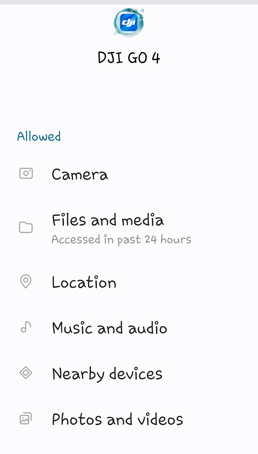

Did anybody find a way to resolve this issue. I'm having the same issue and can't figure out how to resolve it so I can't fly the Spark drone. PLEASE HELP
Galaxy A34 5G
Android version 14
DJI Go 4 version 4.3.62

I just had the same problem. I turned out that while the app was given location permission, location services were disabled on the system level: Settings > Apps > (three dots) > Permission manager > Location
