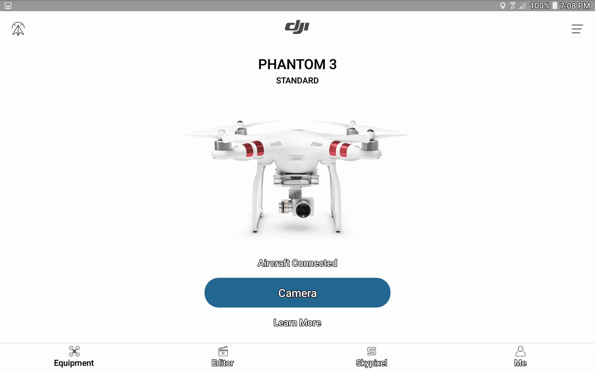

Try just power on remote with drone on then turn your wifi on and let it search out phantom wifi signal,now with djigo home screen when the wifi connects the camera view logo will turn Grey to blue then click it,I dig mine out and take a pic

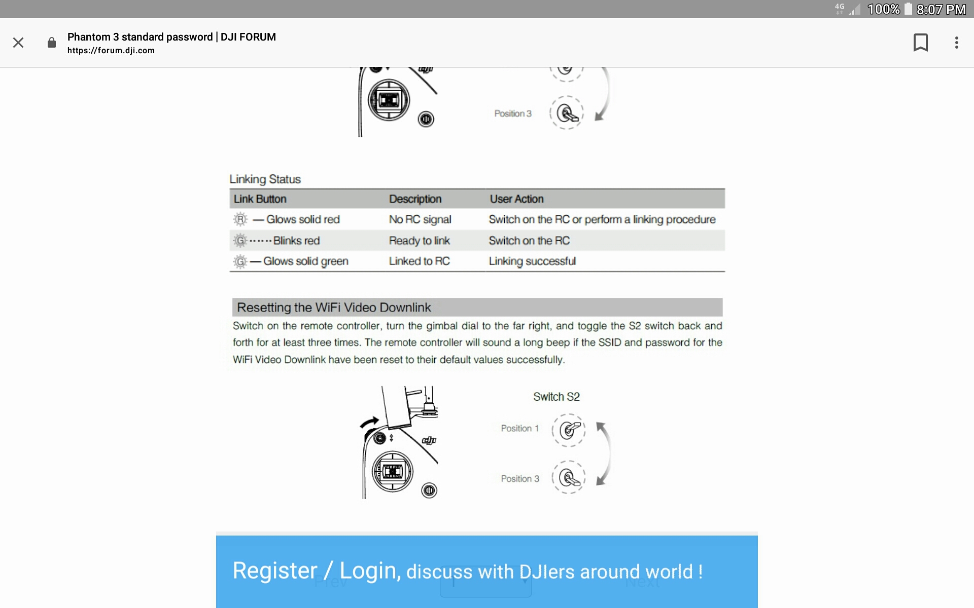

Now I have tried several times to reset til Wi-fi according to Manual (above) with no succes........any other suggestions ?

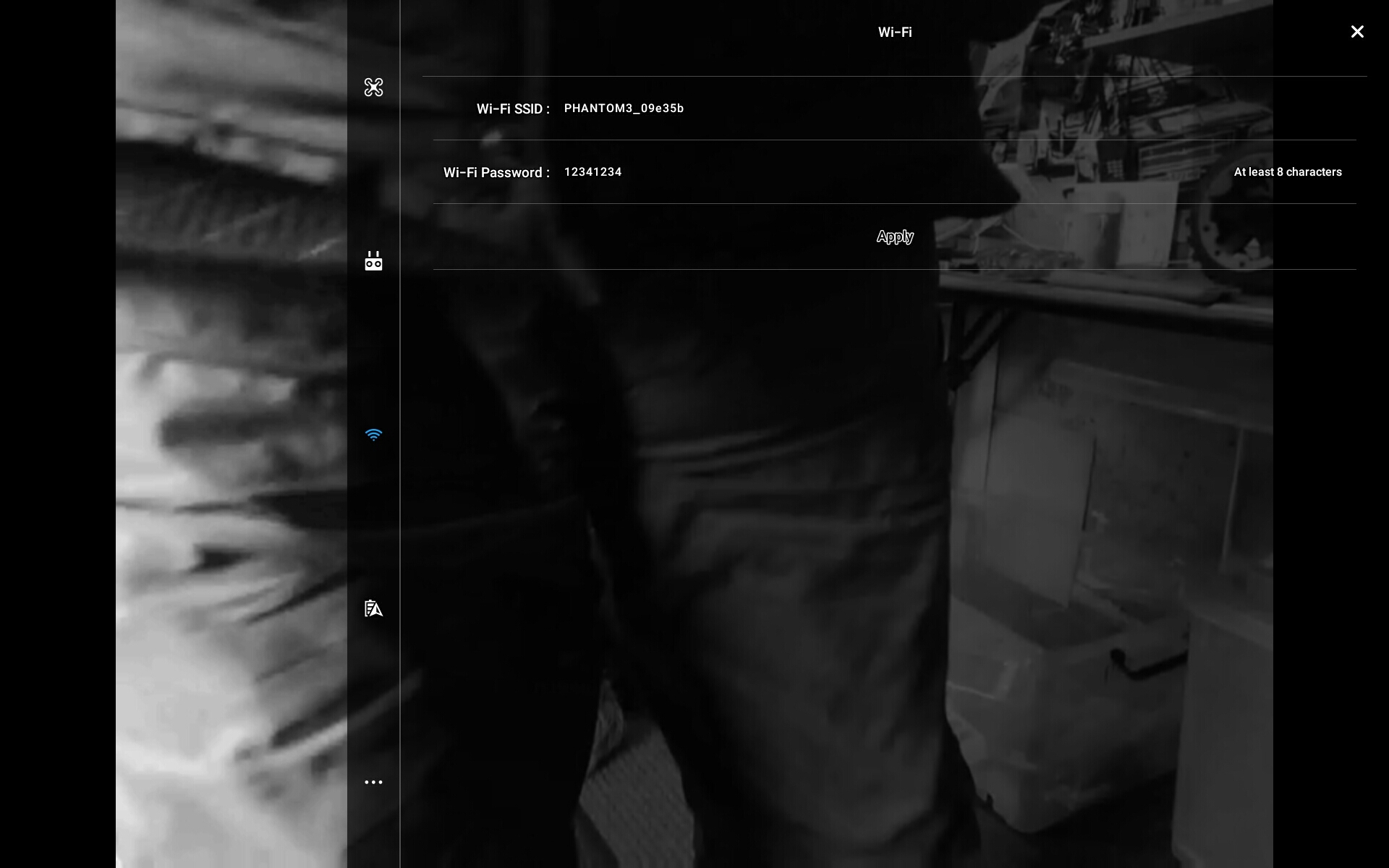

Wow every post I read and look at all the same procedure but they do say to turn off and restart remote and drone after doing this,still searching,any ideas out there,,,see if anything happens in app like this picture when click on "apply"

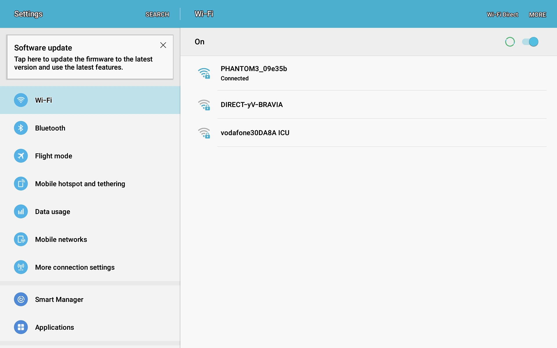

What I have to do, is 'Forget' the phantom in the wifi list then tap it again and enter 12341234 and voila! It should work for you. Let me know if it doesn't and I'll make a video of how I have to do it [every single time] to get connected.
