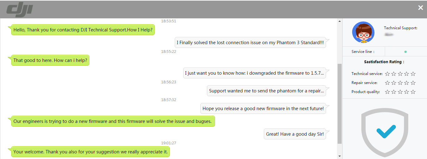

I upgraded and downgraded from 1.6.8 to 1.5.7 several times andcan say the new firmware is definetly bad for video connection! I contacted dji support, they initially told to send the drone for assistance, the they admitted they are working on a new firmware. It seems they have reduced the power of transmission or just reduced the performance of the standard to sell more lightbridge equipped birds.
Does anyone reverse-engineered the firmware or just find evidence of the reduced performance?

I rolled back to 1.5.7 from 1.6.8 as I kept Lodi g video, also rolled back the app too and the range was so much better! Forget upgrading the firmware!

Easy, just put 1.5.7 on sd card and load sd to camera, turn on radio and drone it will update or downgrade the firmware
