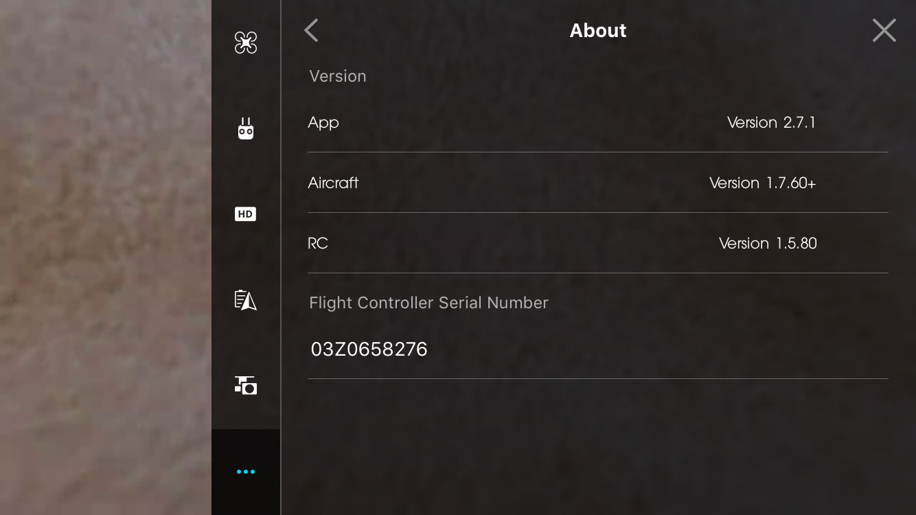

Start up your remote, connect to phone or tablet, start your bird (all the pre-flight steps), go to GO app, go to camera mode, once it connects to your a/c and says ready to fly, open setting menu in Go app, go to General Settings, scroll down to where it says Other/About, look there and it should give you all current versions of the app, a/c FW and RC FW. check to make sure your RC has correct FW version for the current a/c FW.

Added:
Nope messed around a lot..
Asus, connected to remote and bird seeing the camera.
Under About,
app: 2.7.1
ver: 1.4.60
FController has a long serial number.
