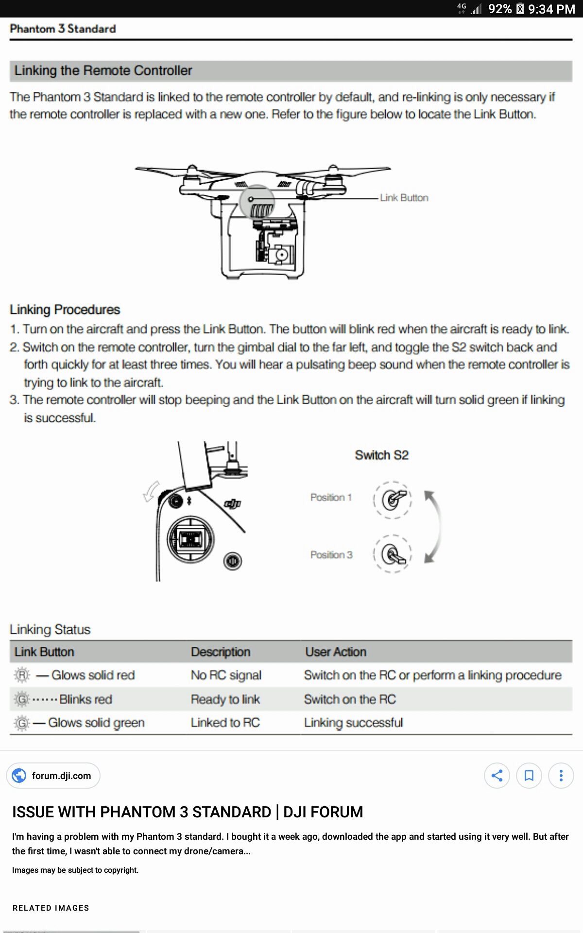

I have tried reconnecting using the DJI app and reset button on the AC and also turning the gimbal dial and flipping the s2 button and then hitting the rest on the AC both methods fail. I have also tried updating the firmware and it fails. First time it took about 5 minutes to fail now every time I try it fails in under a minute.

Can you operate camera with dial,rc solid red I sure is disconected,,what colour your link light,green
As I stated in my post I tried both methods of pair with no success.
Try this method,,,open app on device,turn on drone,get the RC linking on screen and press ,,,now turn remote on and press link button,,,,,,,,if this not work get your home screen up ,,,top right of screen is 3 black lines,,,,press and hole till rc firmware comes up,should give you a roll back on rc firmware,,can you move the gimble wheel with rc ,if so it already linked and something else at play,possibly with the ribbon set even though you say it original parts,was the other to damaged

One other note, the pairing is between the gimbal and the remote. Most I have read, they repair the Phantom they don't have to re-link. they replace the gimbal, they have to re-link.
The only other twist is they can fly with out a gimbal, change remotes, can't fly, re-hook up the gimbal, re-link to new remote, unhook the gimbal, and fly again.
