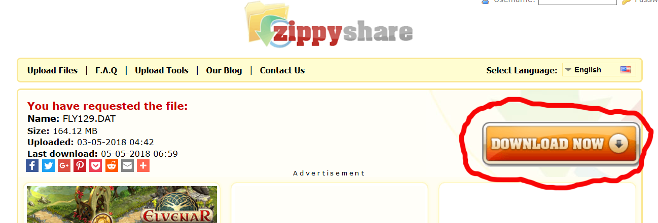

I do exactly that and get
Maybe you could Dropbox it
I managed to download them yesterday from zippyshare, but I still haven't been able to figure out what is causing the wandering. It does seem unusually large. FLY129 is the flight.
