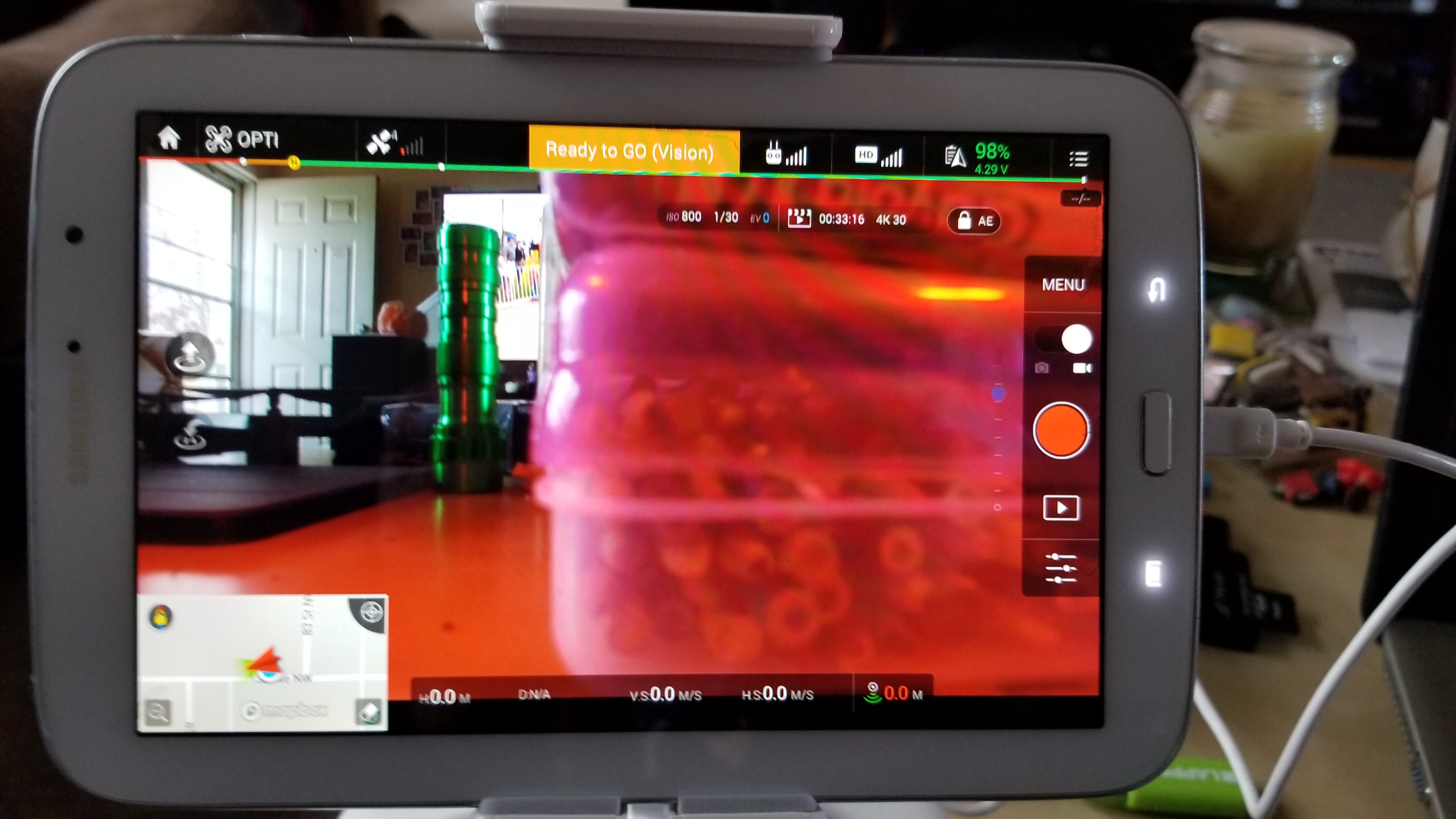

You are not gonna believe this. Assuming I'd get a ton of questions from dji during the warranty/RMA process I went into the settings on the RC and entered flight data mode and connected to the AC via usb and copied all the flight data .dat files to my pc. It said to reboot upon completion to exit. So once the file transfer was complete, i shut down the AC, disconnected the USB from the AC and powered up. Now the video stream is back!!! Go figure!!!
Ok spoke too soon. Figuring all was well i shut down and started up again. Now no video stream. Ugh!!!!
Well, still ongoing, i once again entered "flight data mode" and waited the the status on the RC to say flight data mode reboot aircraft to exit. When i powered up after that my video stream was back. So now im letting everything cool down and will recharge the battery (its at 50% now) and will try again. IF on the next power up the video is gone again my plan is to once again enter flight data mode to reset it, then, put the FW update back in the root directory of the sd card and see if the update is successful this, hoping it will successfully rewrite to the davinci chip and solve any errors. Will keep u updated. Thx for the help everyone :)
Reactions: Oso
Well the 2nd reboot after entering flight data mode worked this time. Video is back and all is normal. After that test i added the firmware .bin file back to the sd card and it didnt even try to update, all seems to be fixed and ive done a couple flights and a few reboots and the video is back every time. Could the entering flight data be the trick to resetting this all too common issue???

All is still well. My AC is working normally again and no video issues whatsoever. I hope this little investigation into my issues helps many others with a simple fix and not an expensive venture. My AC is still under full warranty so i wasn't overly concerned but im well aware of software issues/conflicts/glitches and i tried all i could think of to wake me AC back up and got lucky;)
I will say this.... I'M NEVER LANDING WITH THE CAMERA POINTED DOWN AGAIN!!! LOL
