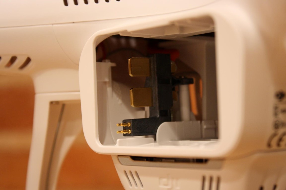

Do you see the same with all batteries or just that one?
Maybe a quick check in the battery compartment for any obvious issues there or on that particular battery's contacts.
Also, does the beeping stop when you move a stick? Possibly an RC calibration including the wheel?
Just throwing out a few simple things to quickly check.

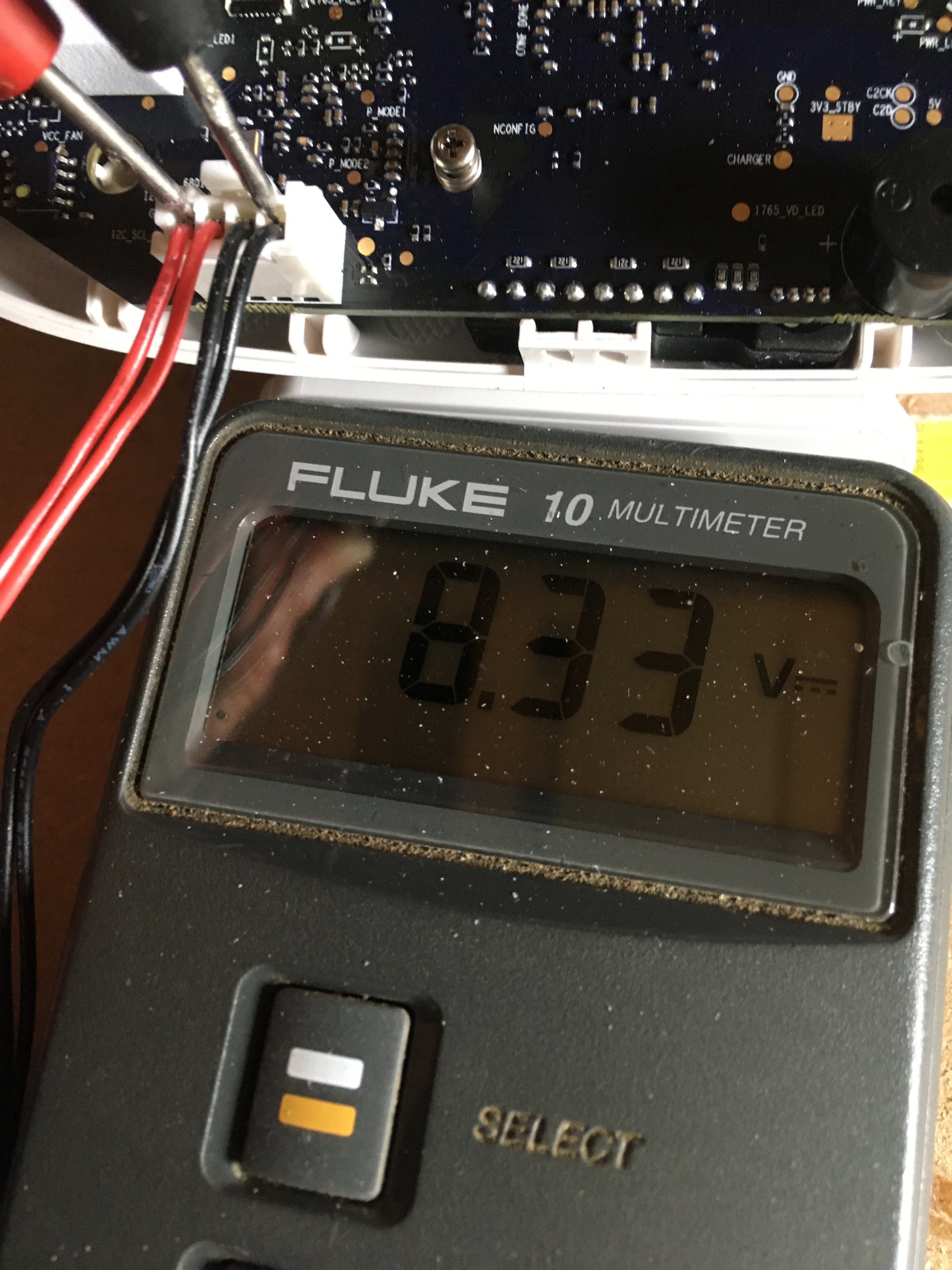

It's not the AC battery, it's the RC!
As I said above I just plugged the charger in the RC and all four white LED's light up one after the other as though the battery was very low.
All four lights off now so "battery charged"! No, turn the RC on and all four less light but the left hand one is blinking g RED and beep beep beep beep. so looks like the RC battery has died!
Now to find out how to change it ?

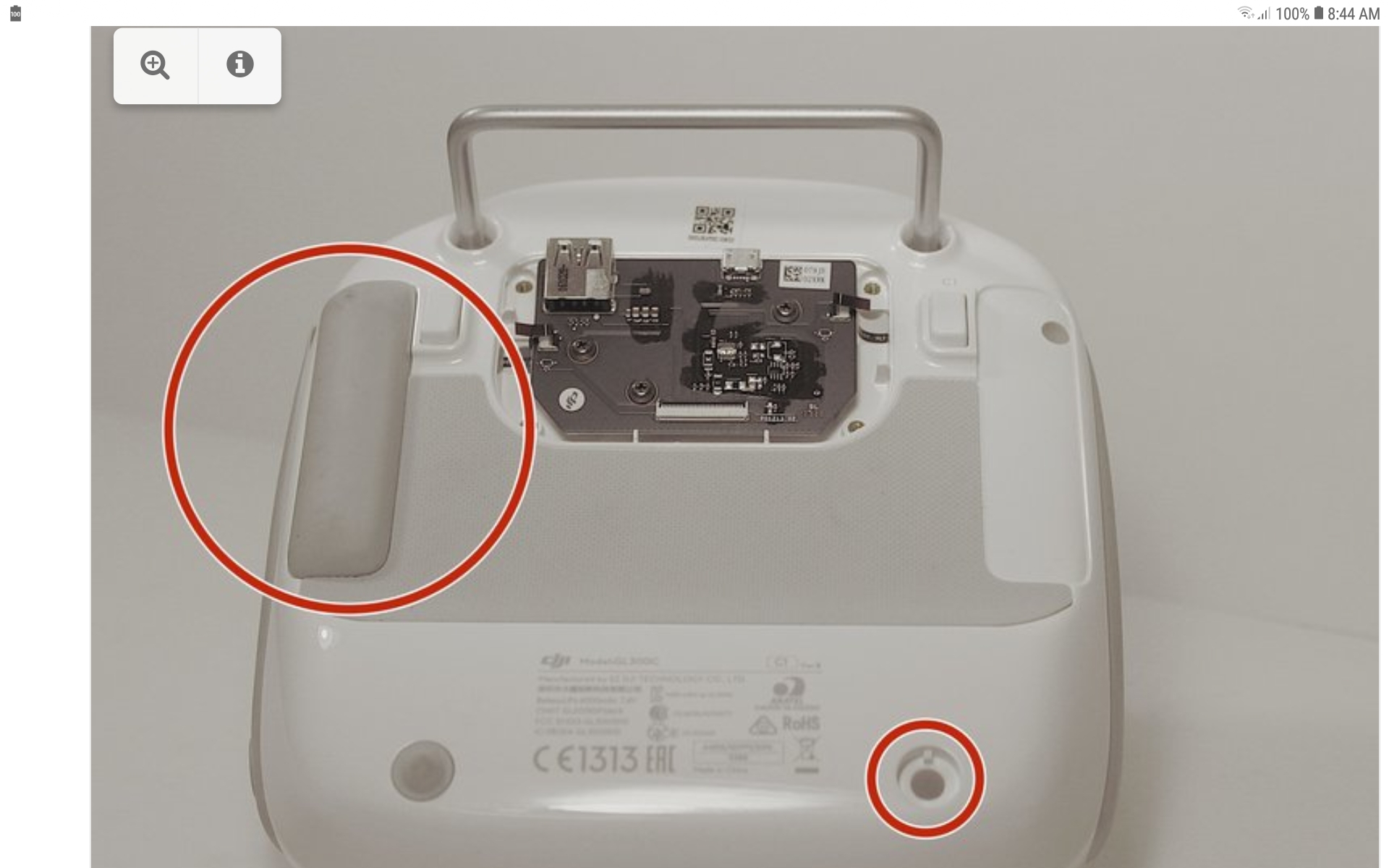

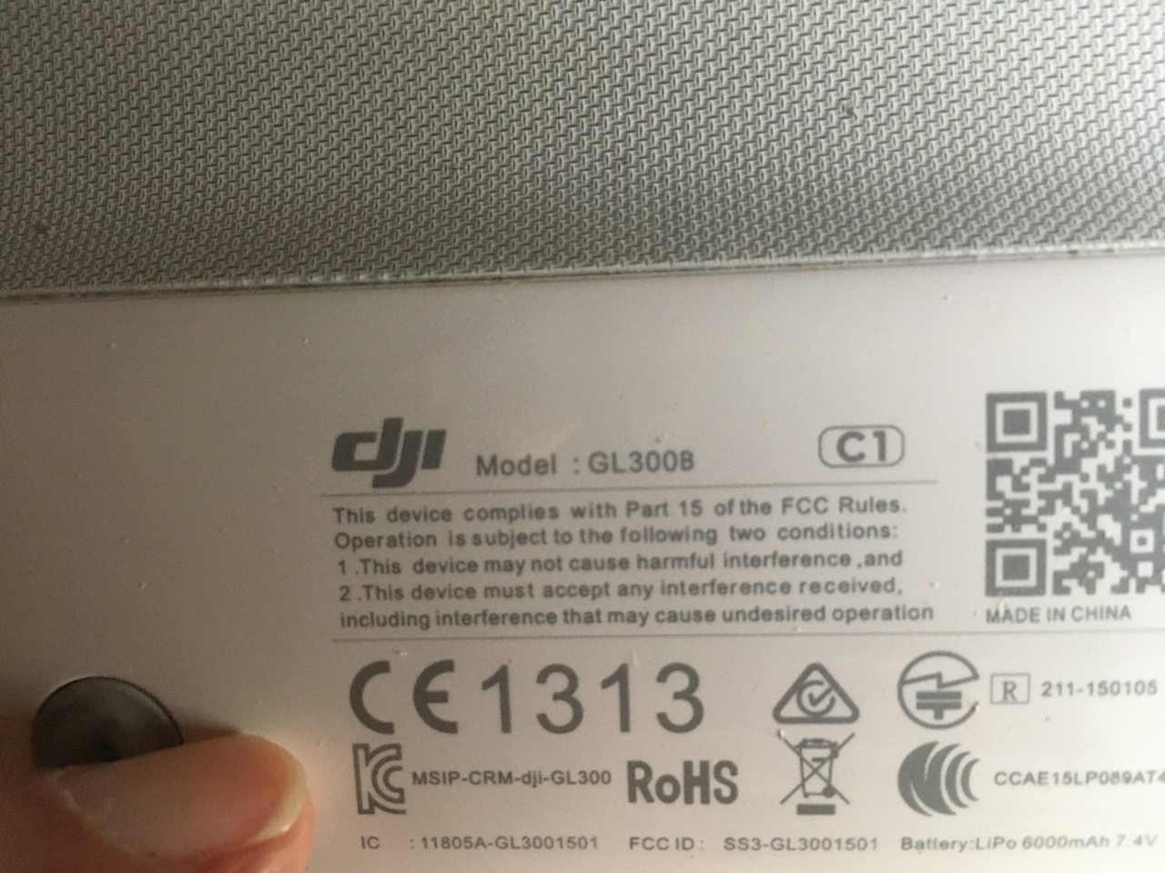

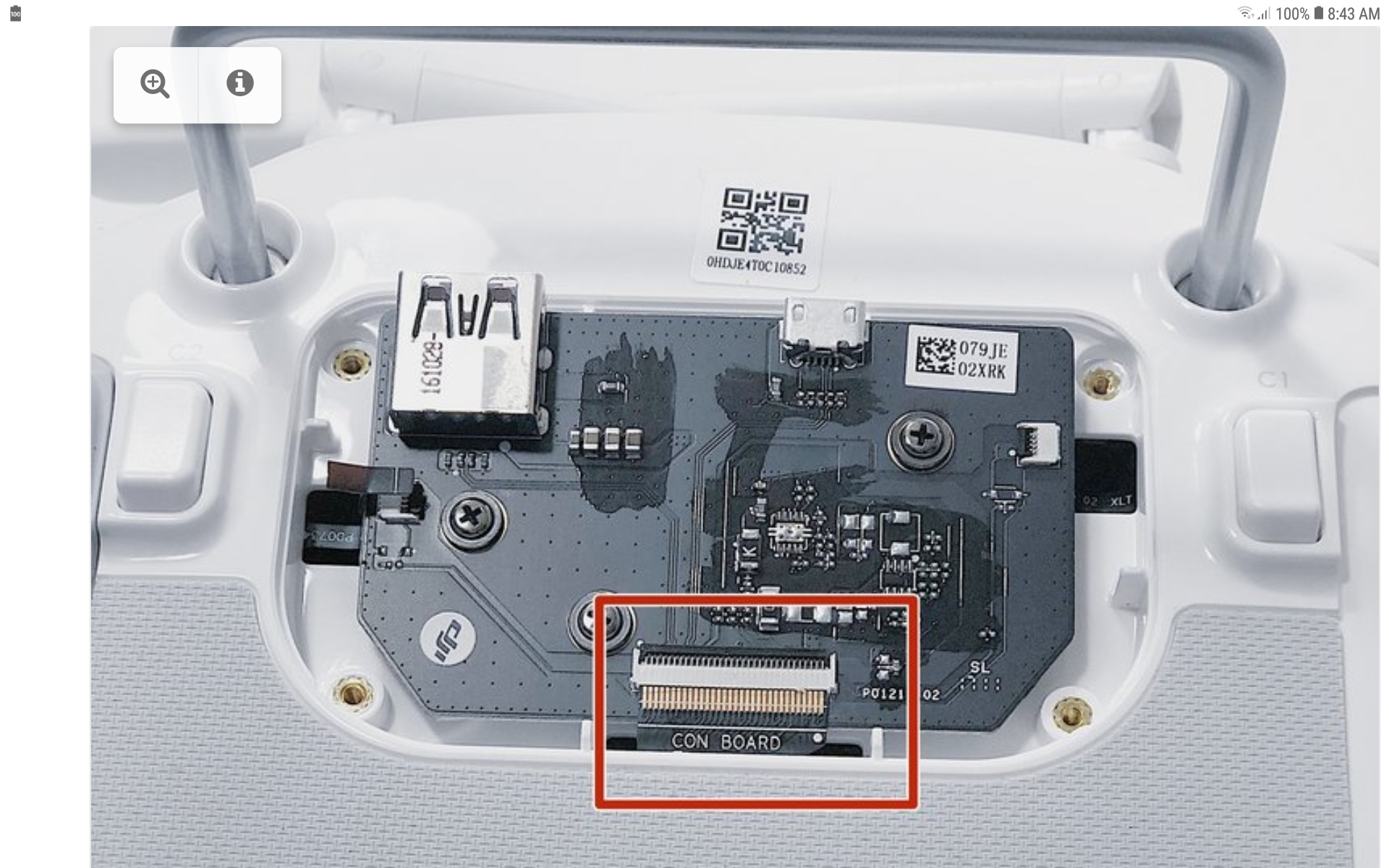

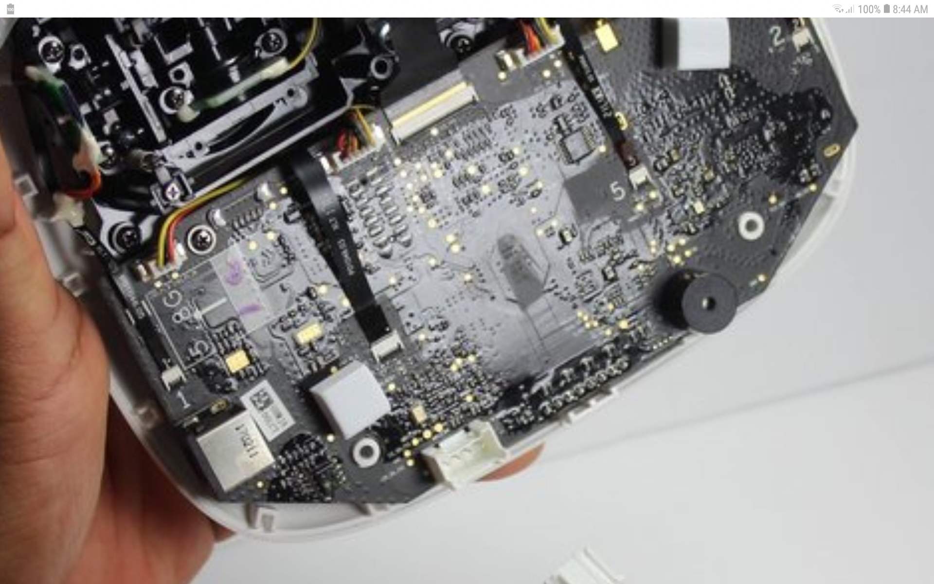

Ok 4 screws where USB port is on rear first so you can detach ribbon cable,,,then remove grey comfort pad to get to other screw as shown in picture,ah shite pictures back to front but you see how it goes,,once screws are out clip remote apart and unplug battery from top board,,,you will now see battery inside rear cover,,,if you got some batterys around you might have a 7.4 600mhp battery lying around that might fit,possible plug change but easy and save you buying replacement remote battery ,,,good luck very easy,,,10 min job but take time on the ribbon cables ,they can be bit fiddly

Ok 4 screws where USB port is on rear first so you can detach ribbon cable,,,then remove grey comfort pad to get to other screw as shown in picture,ah shite pictures back to front but you see how it goes,,once screws are out clip remote apart and unplug battery from top board,,,you will now see battery inside rear cover,,,if you got some batterys around you might have a 7.4 600mhp battery lying around that might fit,possible plug change but easy and save you buying replacement remote battery ,,,good luck very easy,,,10 min job but take time on the ribbon cables ,they can be bit fiddly View attachment 122528 View attachment 122527View attachment 122525View attachment 122526

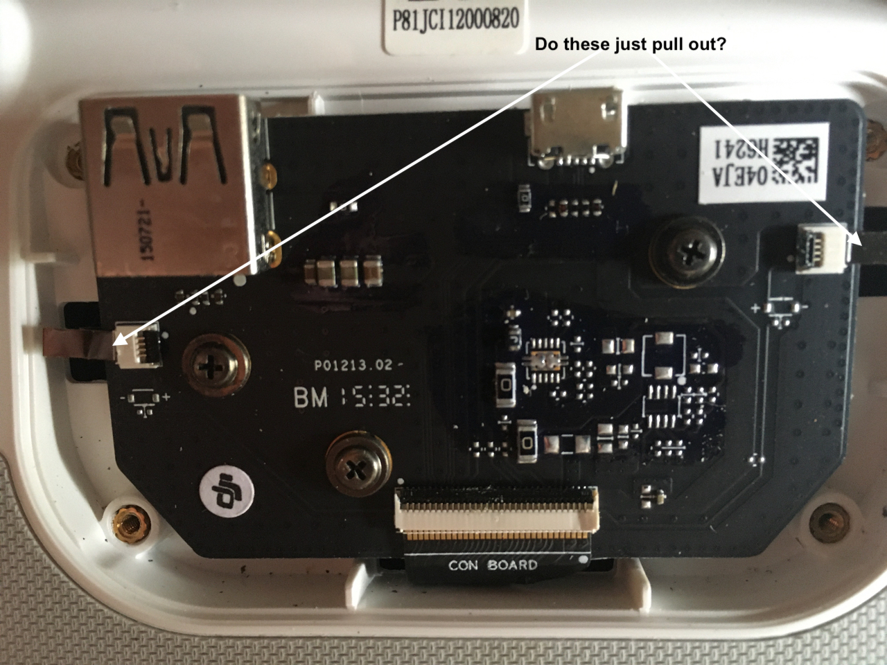

This is where I am ianzone - my controller is:
and this is the USB circuit board:

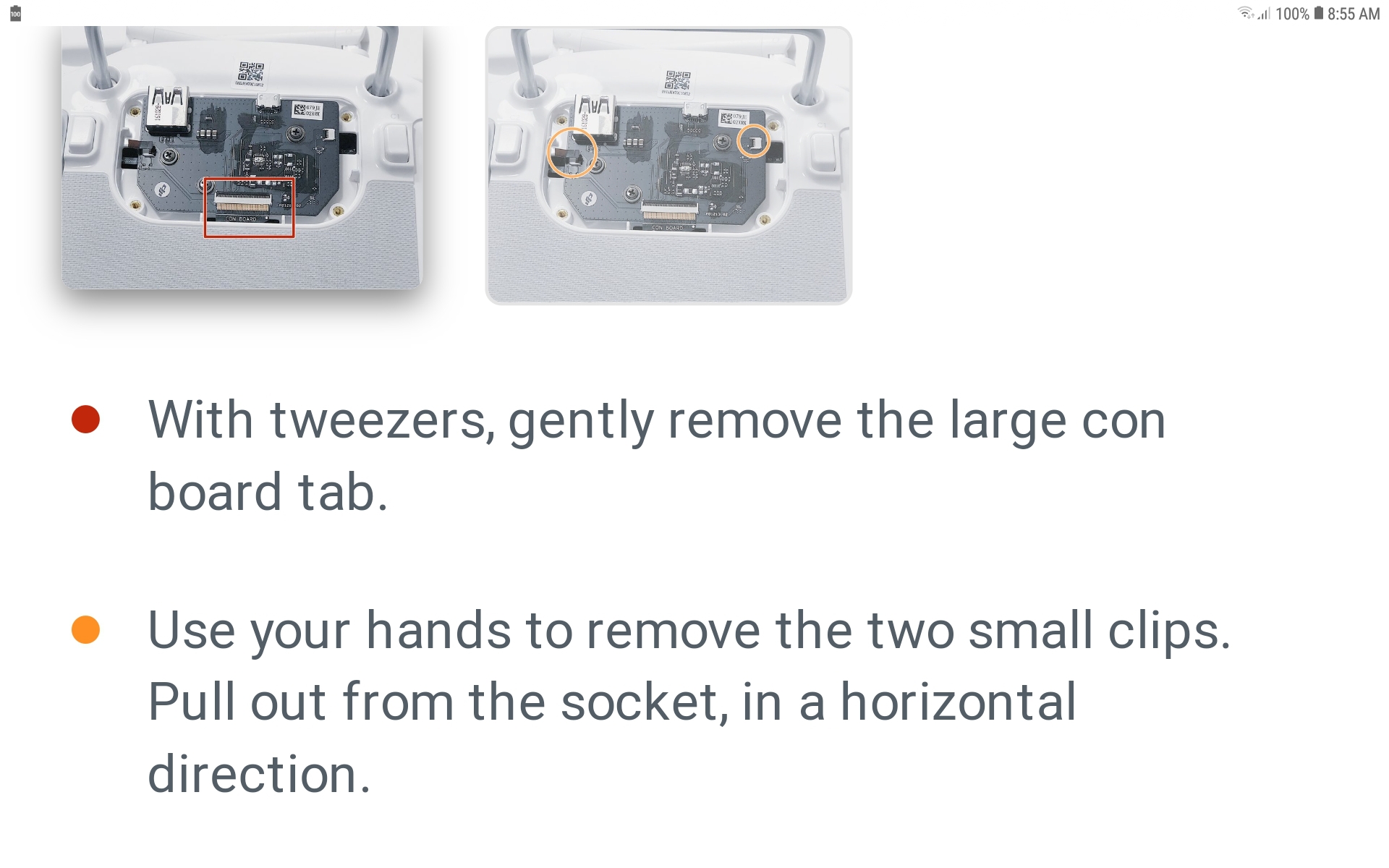

How do the ribbon cables come out, just pull them or is there a locking clip??? Scared of damaging them!!
