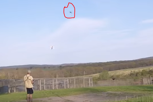

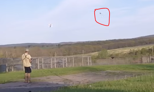

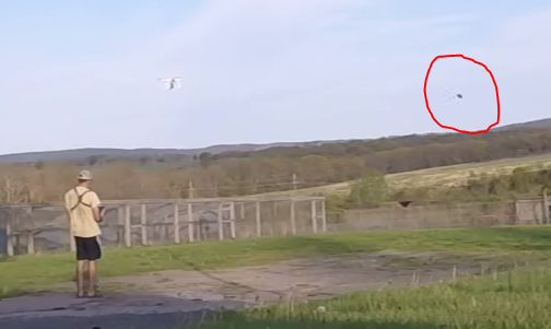

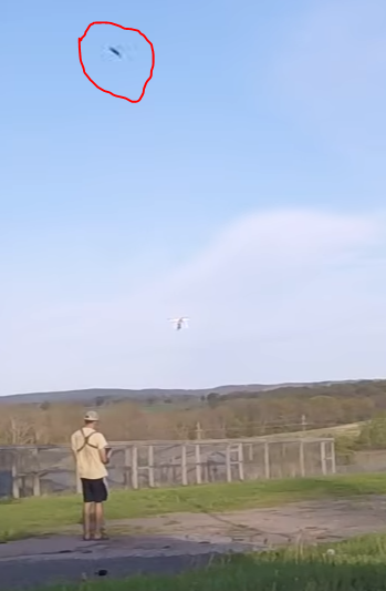

I find two things of interest. Scrubbing back from the frame showing the "prop" flying off I found a couple more frames with this object further away to the right. That along with the direct of flip and the fact that the "Motor Idling (Loose or Missing Propeller)" messages don't start until AFTER the craft has hit the ground! I think this was a (very fast) bird strike coming in from the right, which caused a tumble to the left, sending the bird (or whatever object it was) shooting up. This caused the crash, the broken propeller, and the subsequent error messages.
:38
:39
:39
:39
If that is a prop, it is a very big prop.
And it appears his props are the standard DJI white, not dark like the object above.
If I missed something here, please let me know. I would like to get this figured out correctly.
:38
:39
:39
:39
View attachment 82427 If that is a prop, it is a very big prop.
There is a good reason why many birds, particularity predatory sea birds have white plumage on the underside. Regardless of what colour an object is it will appear dark in silhouette in front of a bright object. On the availabke information prop loss, while not a certainty, is the most likely scenario in this case. The missing prop was found intact, if it struck a bird or other object it may have broken but it would not come undone (the impact would tighten it).
Still does not explain the log. In 6/10 of a second the aircraft went from stable flight to lawn care. On after hitting the ground did the error messages start. I'm not saying it did not throw a prop, just that some of these things don't add up. If it was the right front prop that came off the torc should have flipped the bird to the right but the video shows it flipping to the left. I'm no expert, and I don't play one on tv, I just want to know what happened so I can keep my P3P from doing something similar.
The datcon analysis clearly depicts the motor speed increase that is typical of the many discussed prop loss cases, and the prop was found away from the AC in perfect condition.
