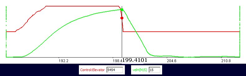

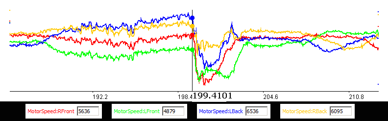

I did a test about 5 months ago to try to determine if an abrupt speed change cause a prop to come off. Maybe the results can shed some light on the active braking question. TBH I don't know exactly what active braking means. Maybe the motor gurus can render an opinion.
The elevator was pushed all the way forward and held until the P3 reached 16 meter/sec. Then the elevator was released causing the P3 to come to an abrupt stop.
Before the abrupt stop the back motors were at a higher speed. During the slow down all the motors decreased speed but the back motors were still higher. When the velocity reached 0 the motors returned to the values before the test.
