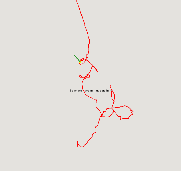

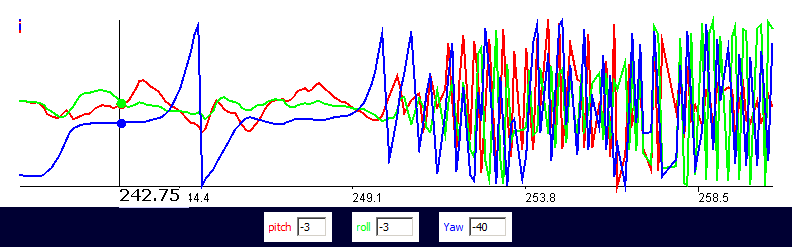

@Erised I thought some more about your comment and I think you're right. IMHO the prop/motor/ESC issue started somewhere around 243, possibly as early as 241. It was about this time the P3 started flying erratically.
Here the GeoPlayer is zoomed in farther than it can get imagery. Up to this time (242.75) path was smooth. After this time the path became erratic.

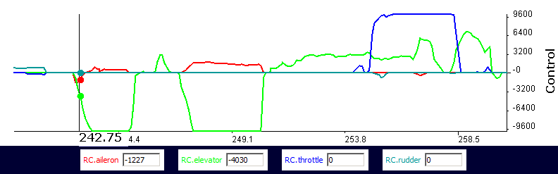

I had originally thought there was enough control stick input to cause the relatively minor yawing, pitching and rolling at 242. I've changed my mind after making an improvement to CsvView to get a better look at the control inputs.
The elevator was pulled all the way back, but there was no other input except a small amount on the aileron. IMO there was no input that would cause the P3 to yaw.

What IF....Around 241 a motor bearing is starting to fail, as temperature rises in the bearing and the internal clearances are almost null, the ESC ramps up the amperage to maintain RPM, works for a few seconds and the slowing of the motor permit some temperature decrease and a bit less siezure, that works for about 4 seconds, then total bearing failure is beyond recovery and the AC tries to compensate but to no avail. Just a theory.
That theory is as as good as any I suppose. I don't know much about motors so I can't add much here. Too bad we don't have the .DAT.
Dat would be nice. The thing that really hits me is the sustained hight amp draw before 244. When bearings fail because of lack of lubrication the thermal expansion in the raceway causes the bearing to tighten up and seize, some so tight that the jammed bearings actually spin on their shafts or in the housing. The high amp draw could be to overcome the friction in the bearing, the bearing could have siezed or the high amp draw could have toasted something else.
