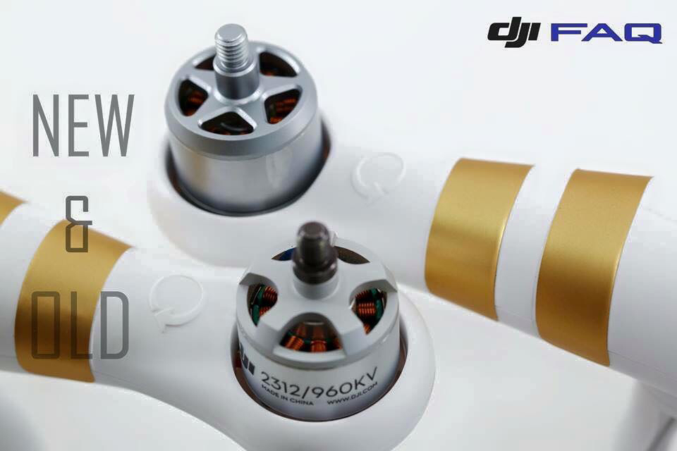

Yes, but you would need to be sure you used the correct one for your type of motors.
Part 33 for original 2312 motors
Part 96 for updated 2312A motors
