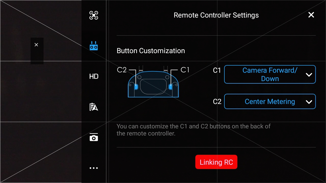

I'm not so sure the drone needs a camera installed in order to link to a controller, because the linking-button is on the drone itself, NOT on the camera (see manual page 29).

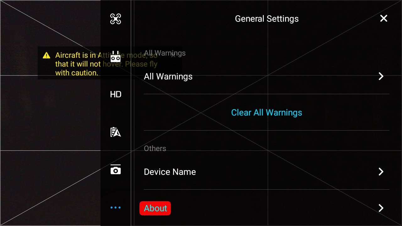

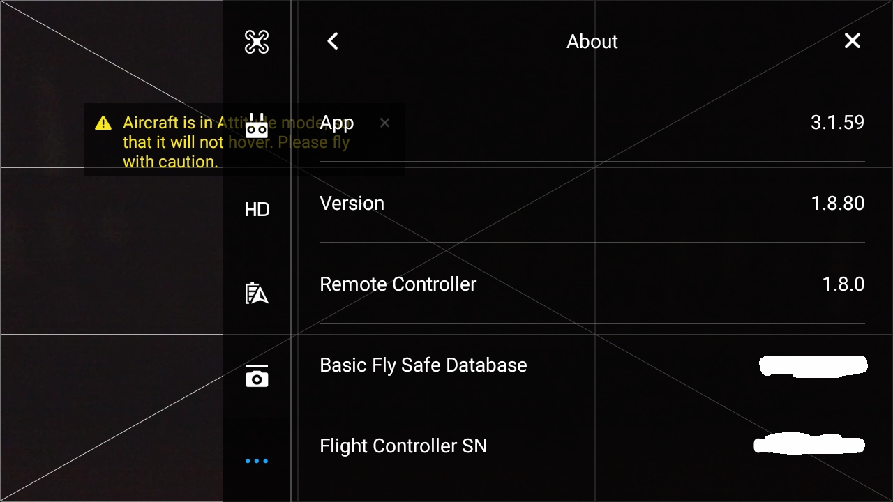

When Drone and RC are linked succesfully you can readout both installed firmwares in the DJI GO app (General settings -> About).
IF there really is a firmware mismatch between the drone and remote you have to consult the Release Notes.

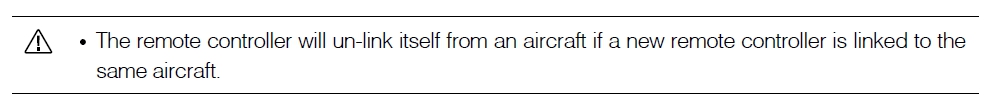

Good point! You can only link one drone to one controller at the same time.
However, there must be some way he can "unlink" from the other controller which he hasn't got?

To unlink you just press link button,,very simple
