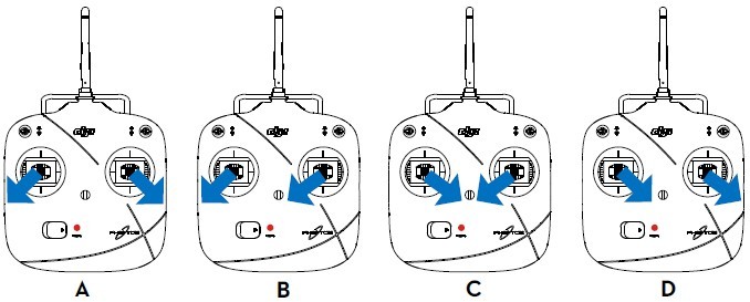

I'm thinking that he might have accidentally executed a CSC (complex stick command) and shut the engines off without knowing it.

Yes, CSC is possible in flight. It's there as an emergency stop method.
No, you are more than unlikely to accidentally do a CSC while flying.
What kind of manoeuvre do you think you'd be trying to make that you'd accidentally use the sticks to make your Phantom go full speed backwards-sideways at the same time it is going full descent-rotating anticlockwise?

You also have to hold both stick down and toward the center for at least 3 seconds before it shut down the motors. If either stick moves away from that position for an instant it starts the 3 second countdown again. In normal flying you would be moving at least one of the controls more often than that.
It's not much of an emergency stop if it takes 3 seconds.
Try it on the ground - it's instant.
It's also instant if you do it in flight but I don't recommend trying it.
The 3 seconds thing is the normal shutdown move after landing where you hold the left stick down for 3 secs after landing.

I'm still thinking that in this case it cant be some accidental CSC move. Being that would shut the motors of but not turn power off to the whole bird and it should not of caused the video to drop out and lose connection to the app and the controller. It would seem if it was from a csc then it would just shut off the motors and then been seen plummeting to the water below on this screen.
No way he was flying hard enough to CSC. CSC is four stick movements fully deflected at once. Pretty extreme. Nothing in the video indicates anything wrong. Odd. Hopefully the telemetry is detailed enough to make a diagnosis.
I've been lurking. I'm a new phantom 3 owner. I personally witnessed friend 1's V2+ crash into some sand on the beach from around 80m up when he let friend 2 pilot it. Friend 2 was not paying attention to friend 1 when he explained of all things what not to do (CSC) when piloting. Friend 2 proceeded to go crazy on both sticks and ended up executing the command. Luckily all it needed was a new cable for the gimbal and a good thorough cleaning.
I'm not saying OP was doing this, but you guys made me think. Today I was trying to execute a pretty complex shot (for me) where I was descending while adjusting pitch and yaw and tilting the gimbal. I realized after reading this post that if I had held the right stick down any further I would have thoughtlessly executed the CSC...I'll be sure to keep that in mind now. I was flying over a though, not a river thankfully.
