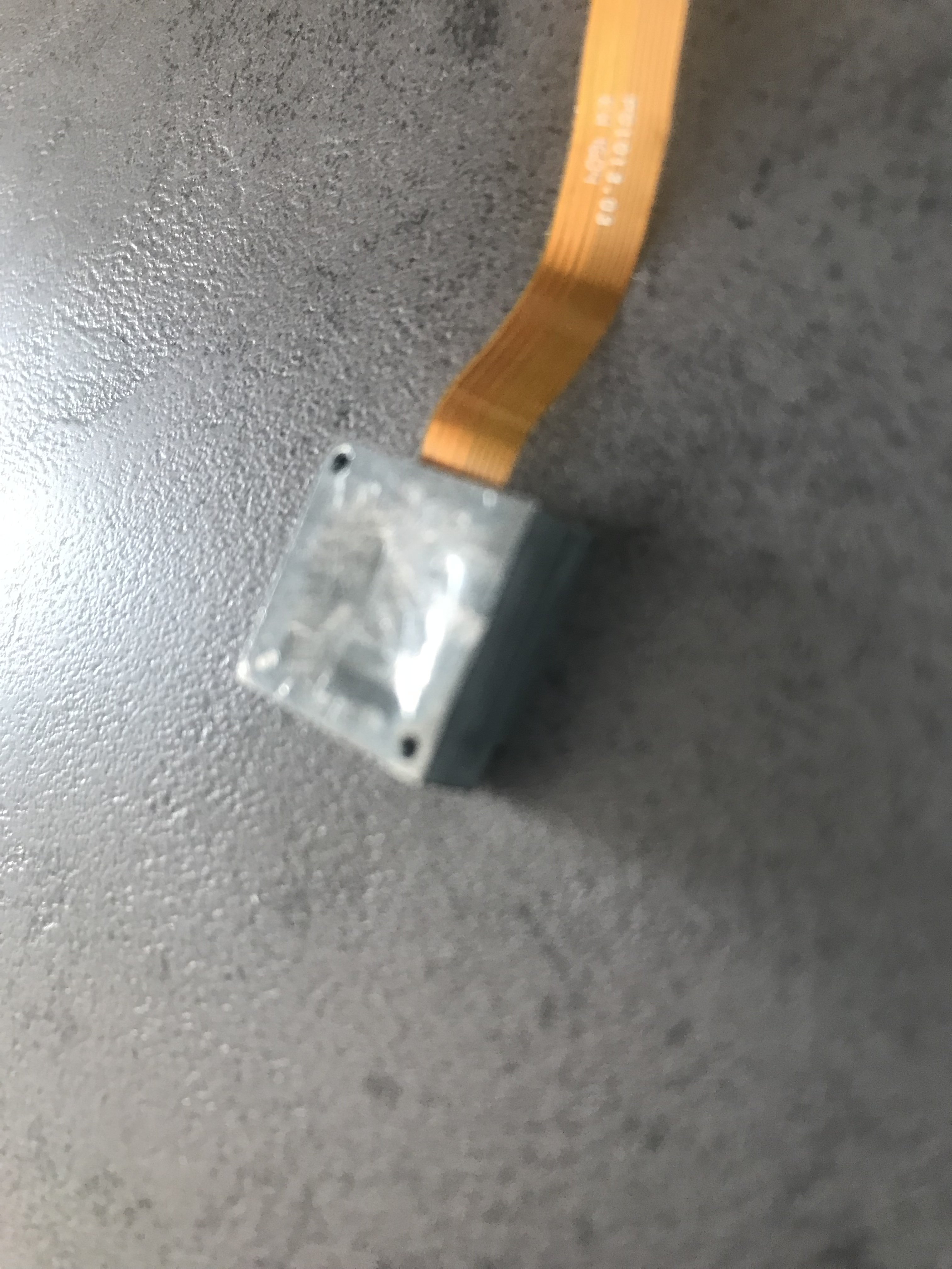

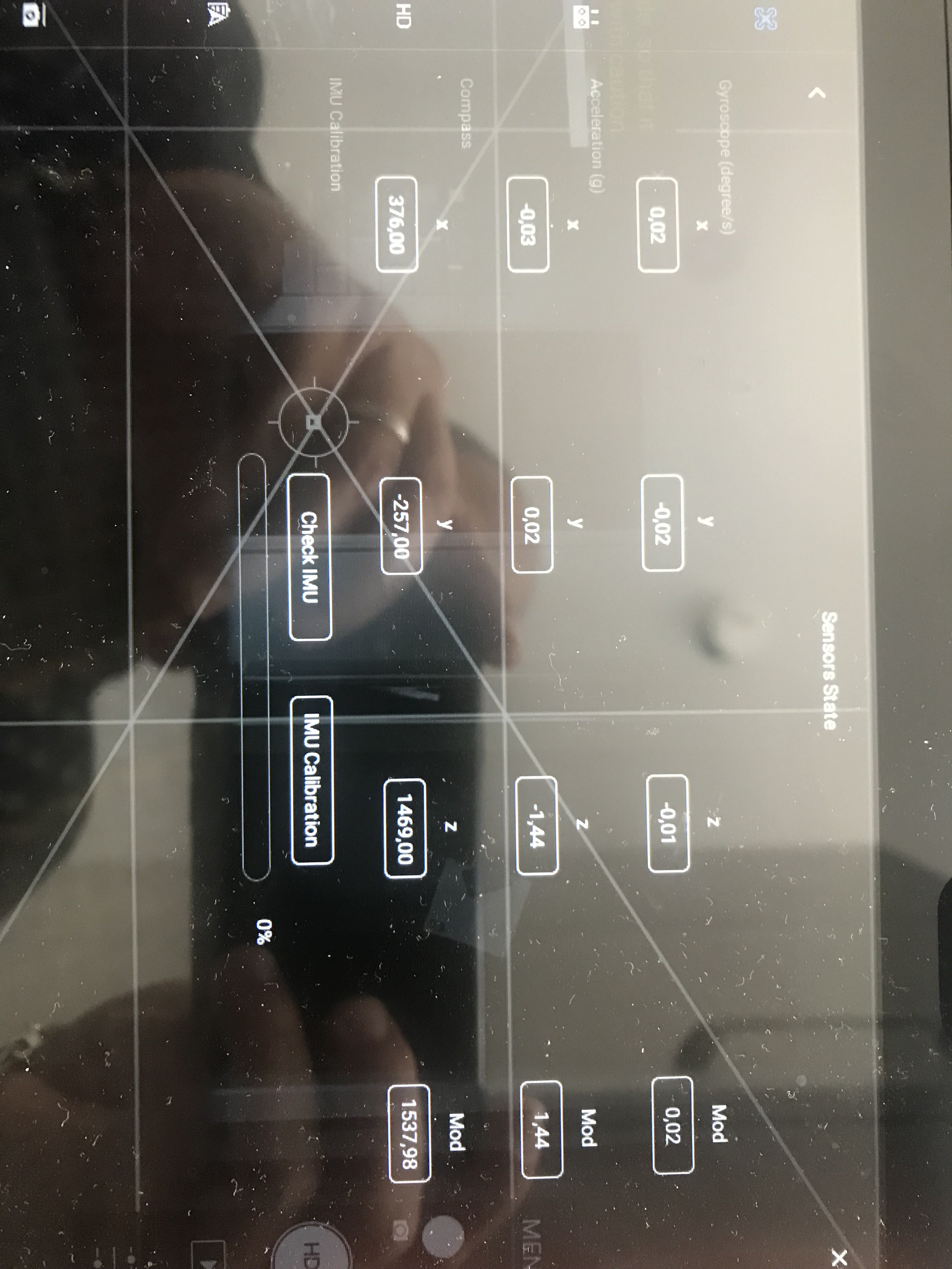

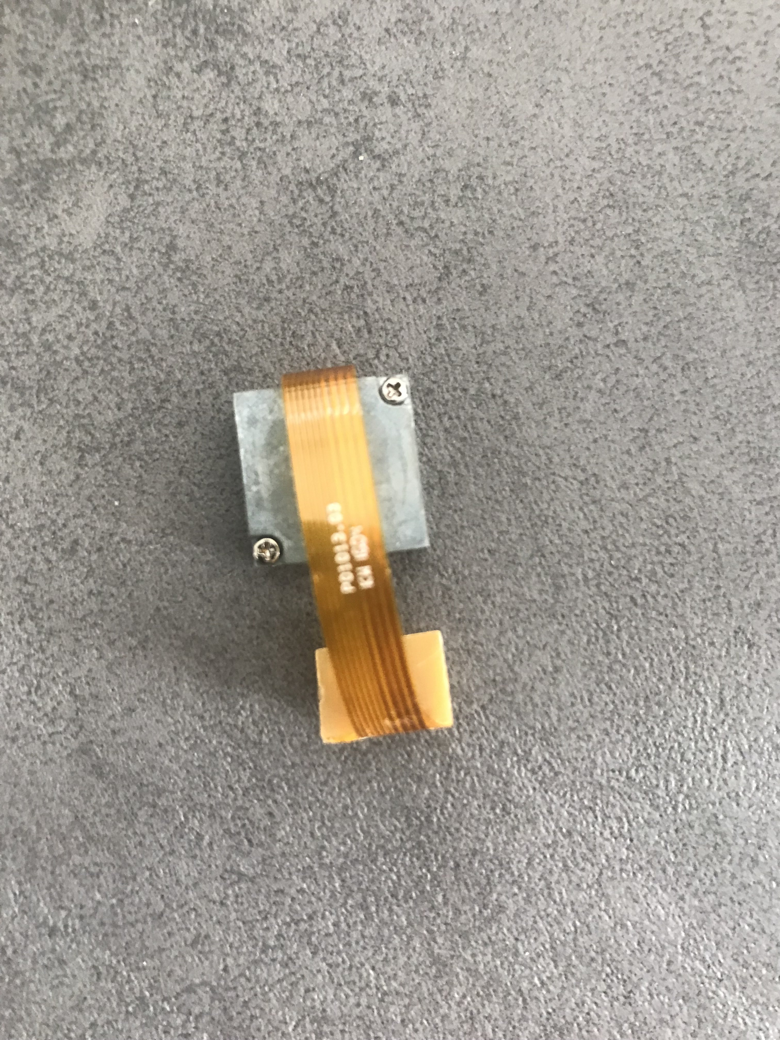

here, I can say that I tried everything without any result, finally I just have to open this **** imu with the 2 small screws !!
I opened it, I tapped it, I threw it hard against the ground, I tapped it with a hammer to the point of deforming it, but the value always remains the same! Z: -1.45
it's incredible!!!

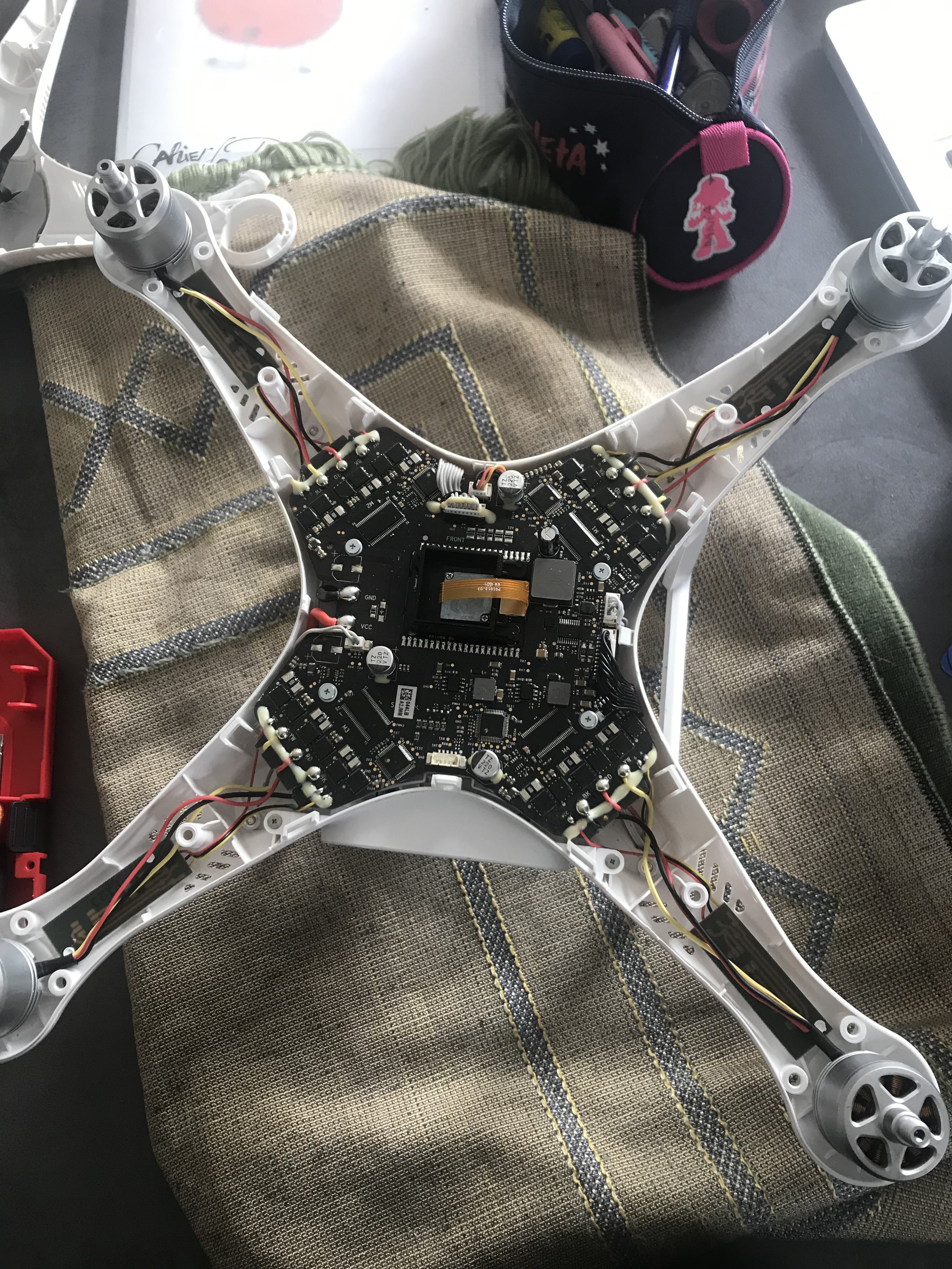

I have not seen a IMU attached with 2 screws like in your photo above, on a P3A. They have always been attached to the main board by 4 small screws from underneath on bottom of the board. There is 4 small plastic tabs that holds the IMU sensor in the IMU housing. The housing stays screwed on the circuit board.
not most of the imu that I saw on the videos are identical to mine.
it is housed in a small black box in the center of the motherboard, then it is connected to it by a connector.
so if that's really the problem it's easy to change it provided you find a compatible and inexpensive
I wonder if this problem is not related to this noise was made. because when it was working I did not have this noise at startup
