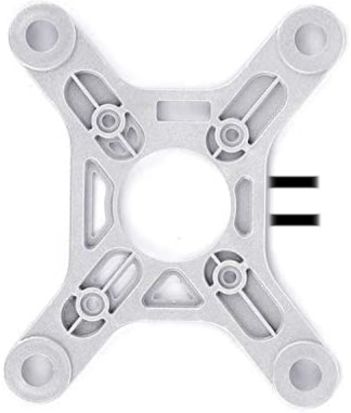

I ordered a mount plate from Amazon which said will fit P3 Prof & Adv, but did not say fits 4k version. The contour & holes match the 4k plate, except the 2 protrusions that go against sensor body are not in the new plate (see the 2 black shapes in pic below), but I guess it should be fine. Anyway currently I have my home fabricate plate on the drone. Sure I will calibrate RC and report back.

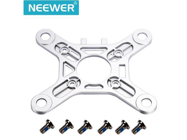

I just noticed exact item on newegg.com (Neewer for DJI Phantom 3 Professional and Phantom 3 Advanced Quadcopter Camera Anti Vibration Shock Absorbing Board, Vibration Damping Plate, a Must for Beginners and Junior Users - Newegg.com). It is called 'Neewer for DJI Phantom 3 Professional and Phantom 3 Advanced Quadcopter Camera Anti Vibration Shock Absorbing Board, Vibration Damping Plate'... just in case any 4k user needs it.
I ordered it and will update the forum once I receive the item on its fitment
