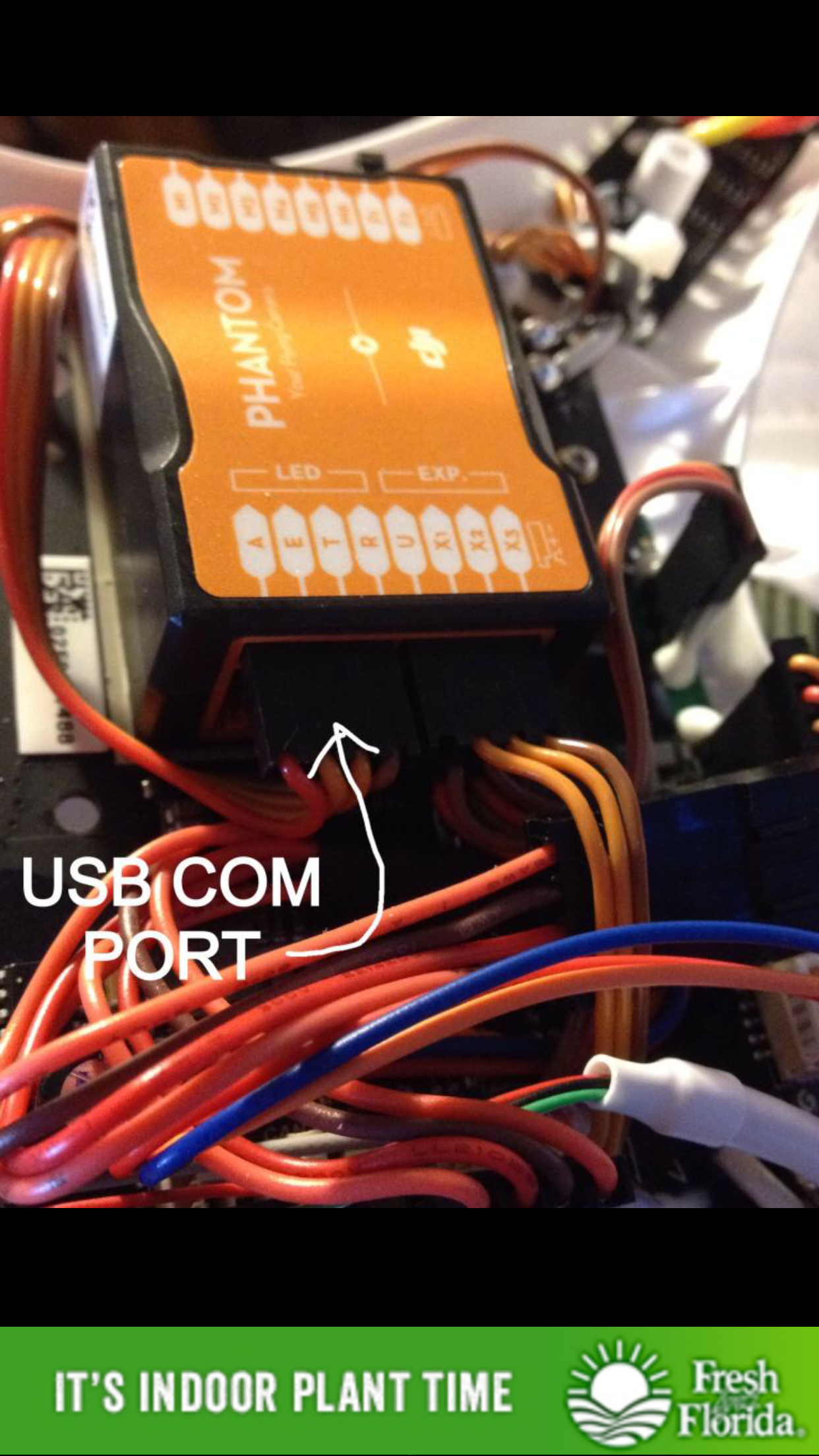

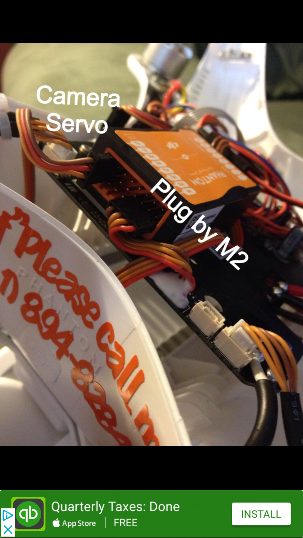

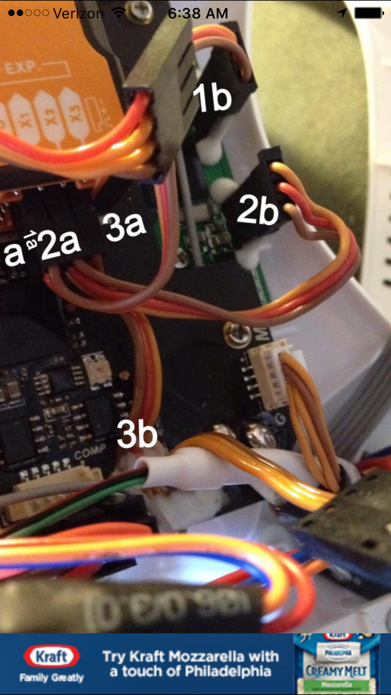

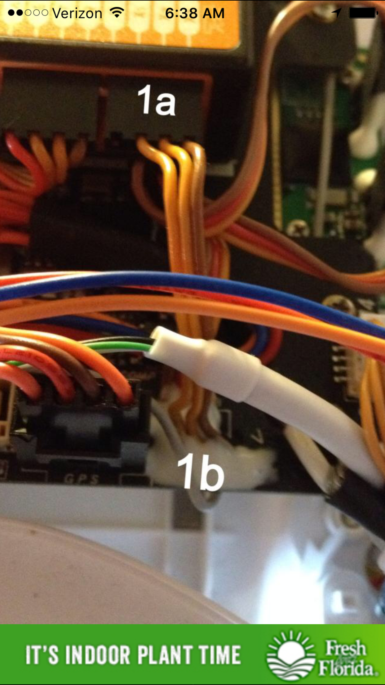

Sounds like something plugged in wrong or not plugged in?
Can you open up the top, and take pictures of your hookups?
This will help me find the issue.
J Dot
:cool:
Here are some reference photos
( pay close attention to wire COLORS , some plugs can be inserted backwards )
Keep us updated !
J Dot
:cool:
View attachment 94048 View attachment 94049 View attachment 94050 View attachment 94051
Keep us updated !
J Dot great job,one of the plugs was in the center instead of bottom. What a great site, people like you go out of there way to help another flyer. have a great day and up comming week. Thanks again
