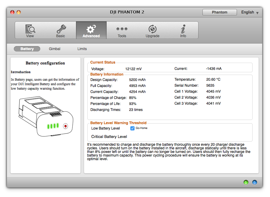

Here are my battery stats on one of the batteries. The two new ones and the the unit that has been cycled 23 times are similar. All 4 give me 3-4 minutes before the failsafes kick in. Any other ideas?
Nope. That's an OEM DJI
If you have one the new batteries fully charged post a screenshot. Are you flying in cold weather?

More than like the previous owner may not have stored those batteries properly which could be why the flight time is so short. Charge the rest of them and check all of them again in the software then post screenshots of all them. Also check those model numbers. The newest OEM batteries model # PH2 which were produced in late 2015

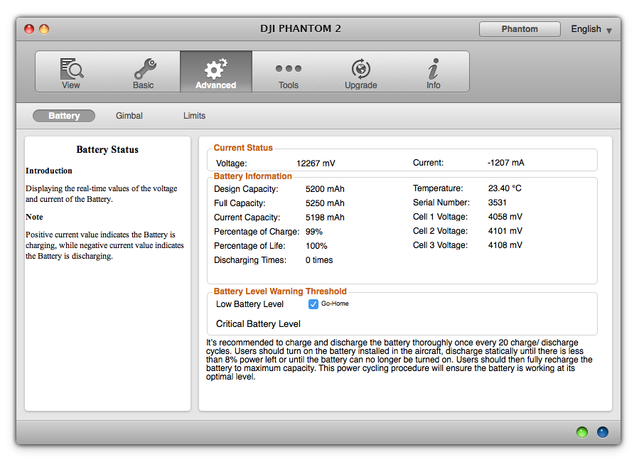

Here is the first new battery stats:
I've seen a lot of ads claiming their batteries are new OEM when in fact they aftermarket counterfeits using DJI's old model numbers. Personally, I do not do business with Amazon nor do I trust them. Since you have a FPV system keep a close eye on the battery performance on those batteries. When the voltage level is close to 10.8 you be close by because at 10.6v it's coming down. I also leave the critical battery box unchecked because if you happen to be under something when you reach the critical battery point you will have damage. CBL works the same way as failsafe.
And the second new battery stats:
