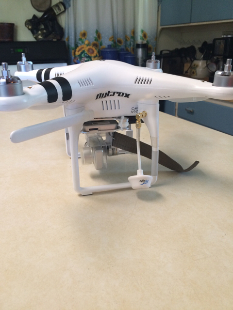

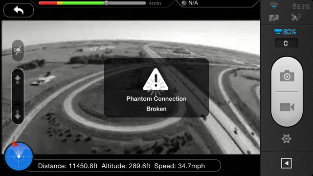

Did you know the antennas off of p3 remote are good for extending wi-fi range on p2v+r
