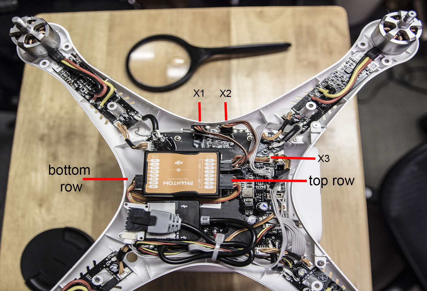

I reinstalled the assistant software and calibrated the controller and did a dry run without the propellers and the p2 still runs at full power I went from Naza mode to phantom mode and still the same Iam just wondering if the X1 and X2 lead are plugged into the wrong connectors would it cause the p2 to do this and thanks a million for all the help

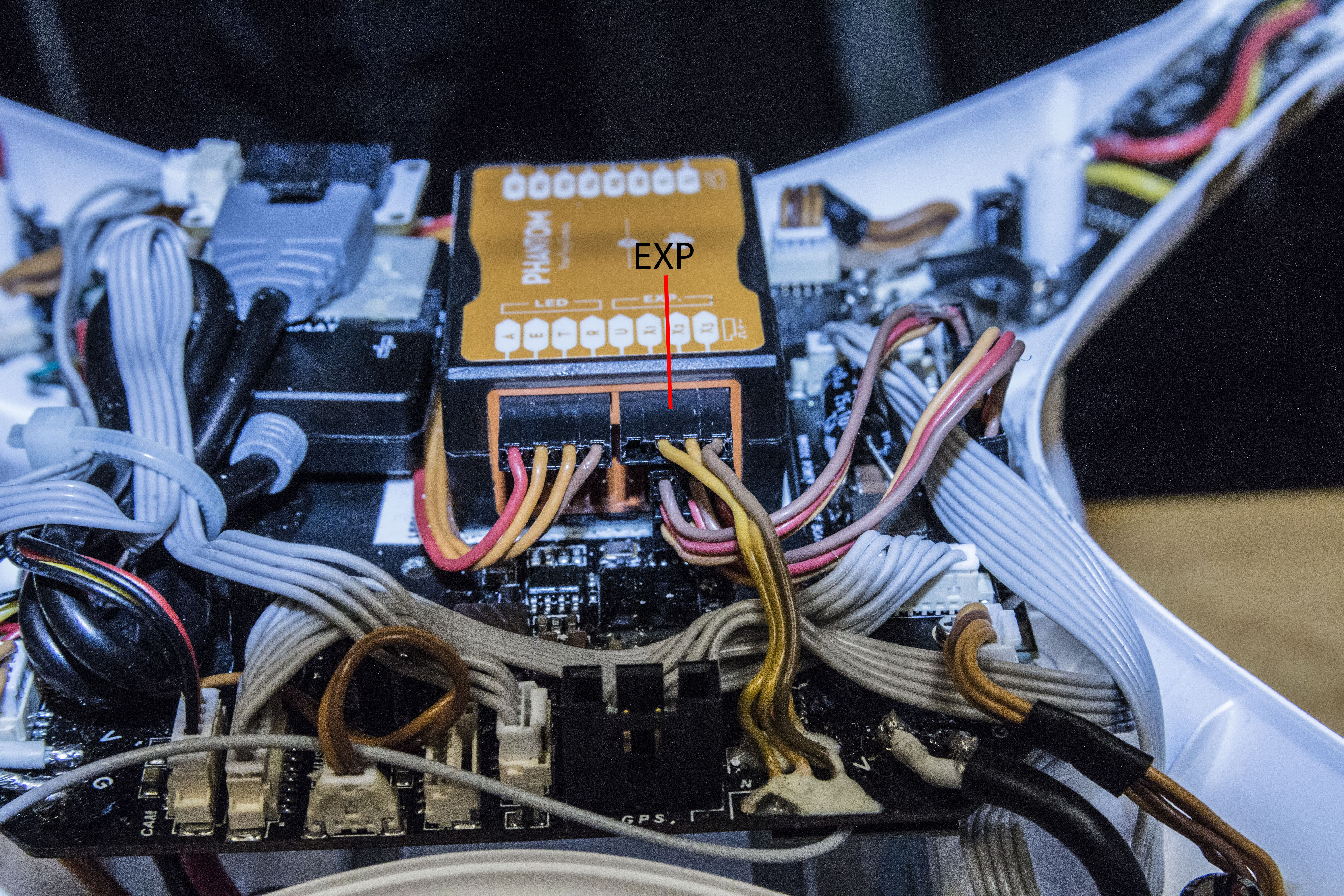

Here are the photos for the connections to the Naza module.

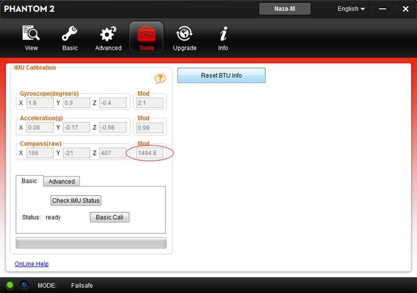

When you do the advanced IMU the compass mod should be no lower than 1300 or higher than 1600. This calibration should also be done on a level surface. You can see the advance tab open it and do that cal. The advance cal is the same in the Phantom mode as well. There's no need to do a BTU reset.
After all the calibrations the compass raw mod is between 1320.0 and 1380.5 is this good and iam getting 1 green light and 2 or 3 red lights would it be something causing the gps to go funny and thanks a million for all the help
