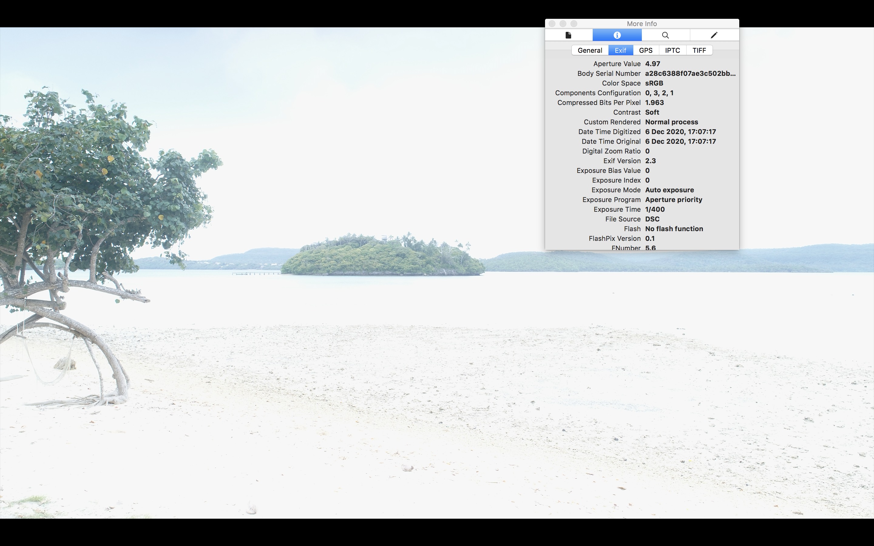

Something is wrong but more information is needed to work out what it is.
Try adjusting your camera settings to A for Aperture Priority, ISO 100 and your aperture to F5.6 like this:
Then shoot an average scene with those settings - no need to fly, just set up the drone on a box or something and shoot a shot of your backyard, a wall etc etc.
Then post the full original jpg here.

Hi Meta4 , Thanks for the help !
Today is overcast here, we are next to the water and surrounded by greenery (In the tropics).
This is the image as per your instructions, as you can see still over exposed, but i have never worked on A before, so this is something new.

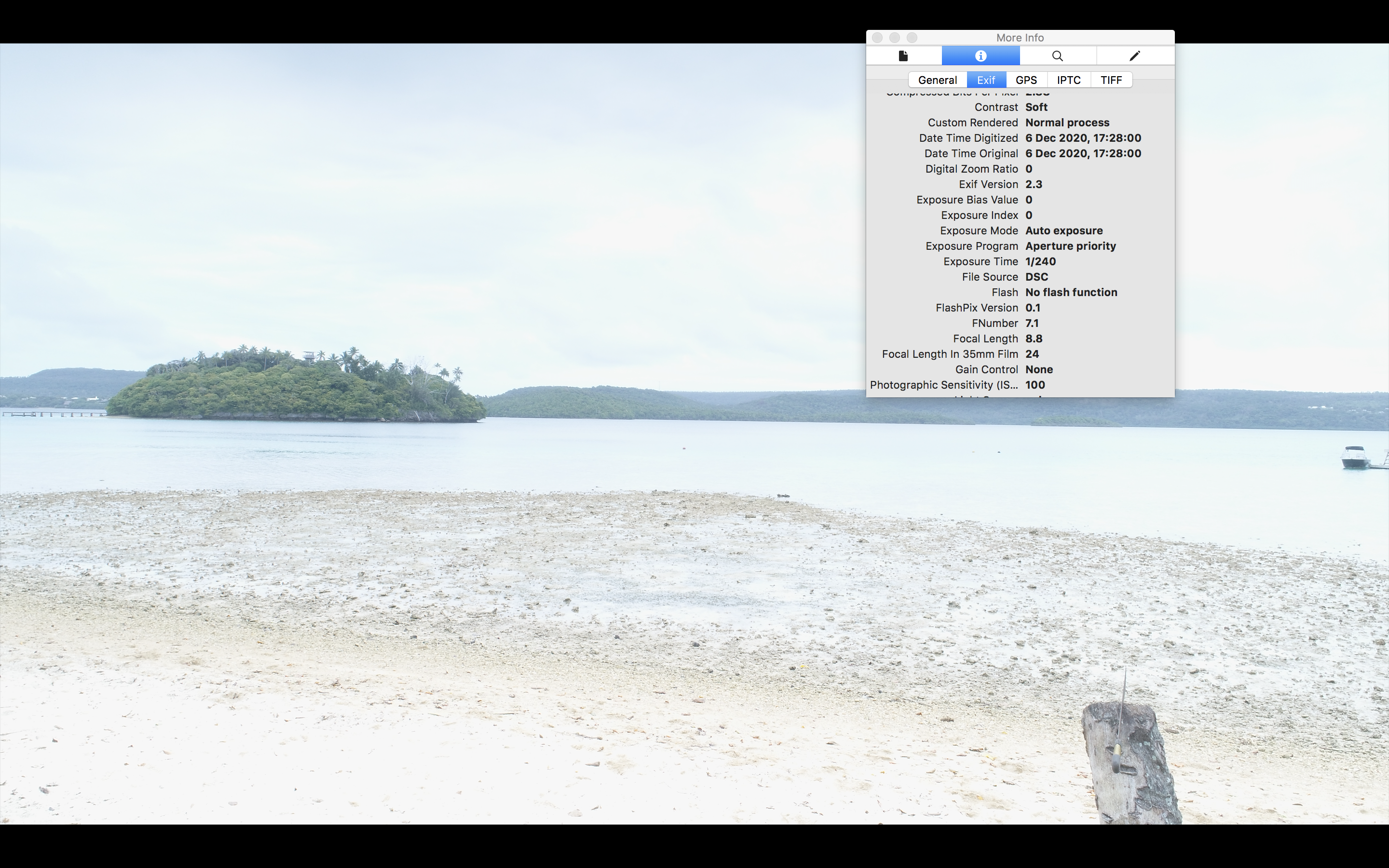

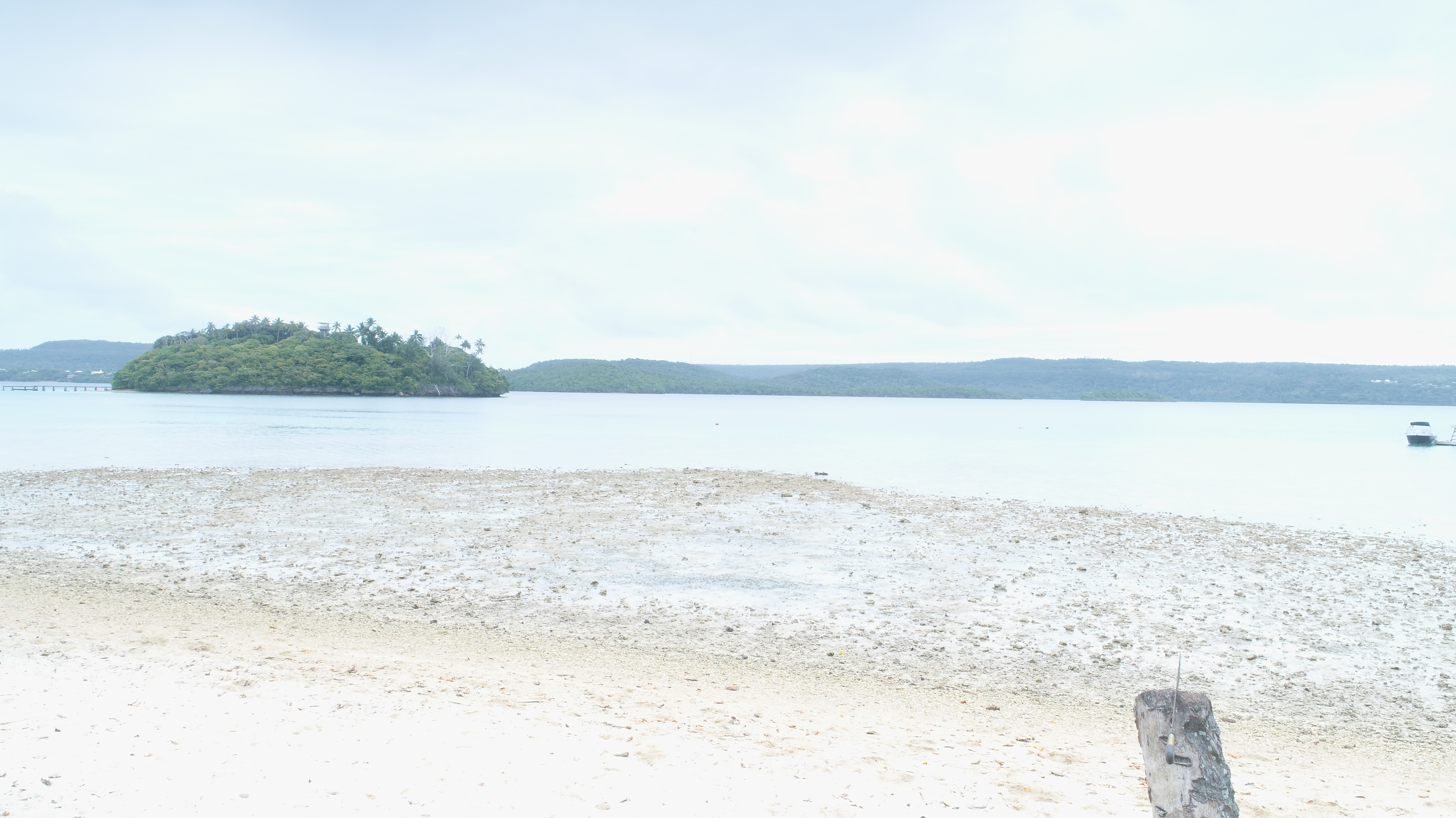

Hi Meta4,
Thanks for the help ! I set up the camera as you said and the image is in the file comment below. I then increased to 7.1 as it was still overexposed. I will still go higher but it's looking much better and i'm feeling a bit more confident. I need a good sunny day to try again and i will let you know how it goes. Much appreciated , Cheers Al
Reactions: JoBe
Hi Meta4,
Can you post the full, original jpg file please so I can check the metadata?
If the camera is set to Aperture priority, and the resulting shot is overexposed at one aperture setting, it will still be over exposed at any other aperture setting.
Aperture Priority means that you choose the aperture you want to use and the camera's metering chooses an appropriate shutter speed to give what it thinks is proper exposure.
If I can see all of the metadata, in the full image, I might be able to work out what's not right.

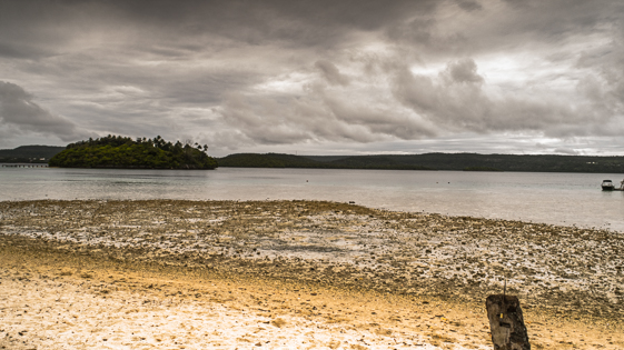

OK ... That looks like your camera's meter is overexposing by about 2 stops.
You could confirm this by leaving those camera settings as they are and adjusting the Exposure Compensation to EV -2.0 and see what that looks like.
I'm not sure what would cause this. One thing to try would be to reset the camera settings to the factory default values and see what that does.
Sounds like a plan , i'll have a go now you've pointed me in the right direction. The light is going here now in Tonga and with the clouds its hard to tell. I did a quick process of that image and it doesnt look too bad but i'm sure i can get it better if i adjust the EV.
That's looking a lot better.
It would be interesting to see what adjusting the exposure compensation does.
2 stops was just a guess, it might need a little more or less, so play around with it to see.
I'd do that first before resetting the camera settings.
Once you know how much the meter's exposure is out by, then try resetting and see if that fixes things.
