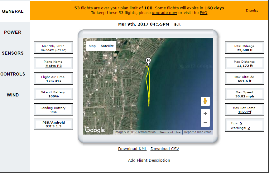

Over 2 miles with a cheap 5.8ghz 14dbi panel!!!
