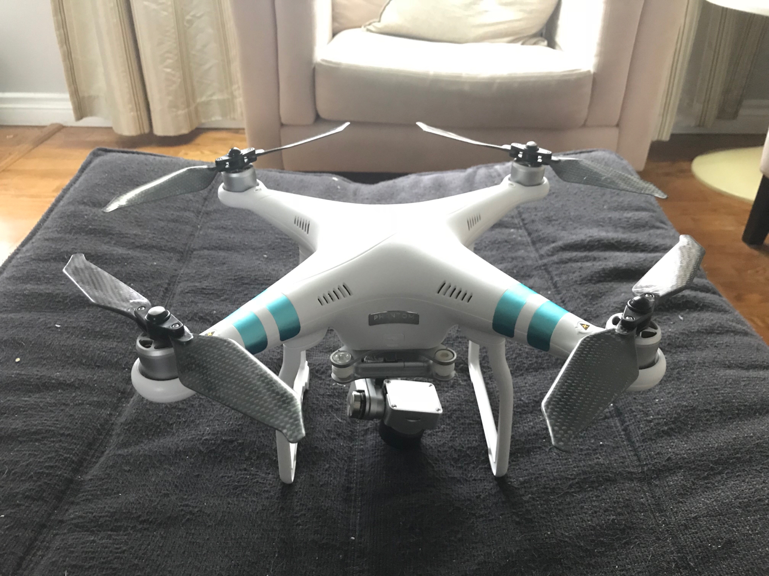

Here they are on my P3S:
Haven’t tried them yet and probably won’t for awhile if at all. Want to do more research first. Regardless, I was pleasantly surprised - they seem well built and solid. They screw on fine but they seem to tighten up faster. They are the same length as my DJI ones but a slightly different shape.

For display purposes only- complete rubbish...
I wouldn’t be risking even a test flight.
Can you see any type of sleeve in the prop roots?
What are the hubs made from? If they are glass reinforced nylon is there a seperate threaded inset for mounting in the motor?
What are the main mounting pins?
Do you have any means of testing the balance?
All questions for curiousity value only. Would be foolish to take the risk flying with them.
Thanks for your comments/recommendations.
The hubs look like they are hard plastic or nylon. The threaded inset appears to be aluminum - 2 silver and 2 black.
The pins that hold the blades are metal with metal liners. Folding and unfolding feels the same as my DJI Spark props.
I don’t have a balancer to check them.
Maybe tomorrow when I am less tired I’ll take more detailed photos of them.

A "Slightly Different Shape" NO !......a Very very VERY different shape....No Slightly to it....they look scary to me. especially the hinges area !.....IF you fly them might be good to have a " POP "... out remote controlled parachute ready !
