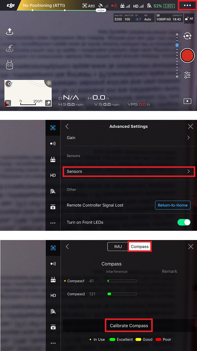

hi I'm trying to find out how to recalibrate my 4 compass even tho the app does not call for it after the set up calibration .is there a way to do this. every time I tap the compass setting to go into to calibrate it does nothing.the only time the prompt came up after tapping is when prompted by app on the original set up .is it just not an option and not necessary unless the app asks you or is there another way to manually go in and calibrate .Thx.
Read the manual on how to do it, then just do it whenever you wish. It is not necessary to wait for a prompt to tell you what to do.
You can also calibrate the compass from the following section of DJI GO:
They changed the app a while ago and moved the calibration to the sensors screen. I am sure the manual hasn't kept up (not sure but they don't seem to update it often).
I think this was DJI's attempt to reduce people's urge to calibrate the compass every flight.
