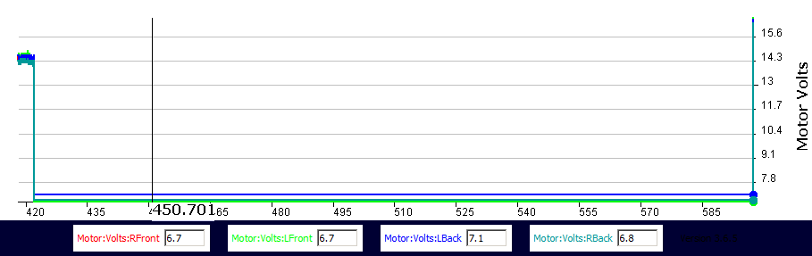

It does appear that there was an abrupt power loss. This can be seen by looking at the motor volts data which is faster than the battery data. At the very end the voltage was about 14.3 volts and then collapsed to about 7 volts.

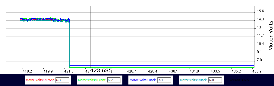

In addition the .DAT file itself was corrupted. This is indicative of an abrupt power loss most likely caused by the battery being dislodged.
110904
The recording terminates at 421 secs but the file isn't closed properly due to the power loss. There is a bit of data left over from the previous file that occupied this portion of the disk. The above graph shows that previous data on the far right. If CsvView weren't so lame it would show a gap between the actual data on the left and the left over data on the right.

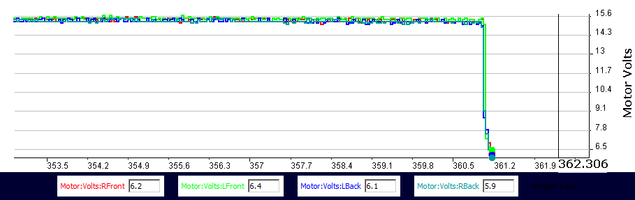

This flight dated 2019-4-20 (the incident in this thread) suffered from an abrupt power loss - either a battery failure or the battery coming loose. At the very end the motor volts collapsed from about 15 volts to about 6 volts.
