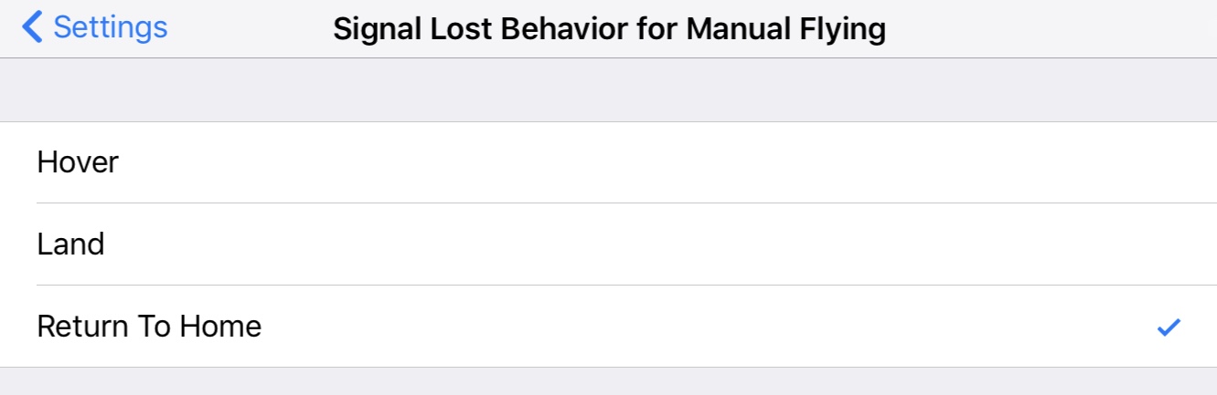

Someone check me on this, but "Hover" is for "End of mission." Signal loss should trigger post mission should trigger RTH for ANY automation software, yes?
From the Litchi settings screen:
Reactions: RodPad
Bsartist is correct. I was using litchi, and always have it set to "return to home", but for whatever reason it was on "hover" in this instance, which is beside the point as we were able to recover the drone after it was "lost". The issue now is figuring out why the two won't connect.
Reactions: RodPad
