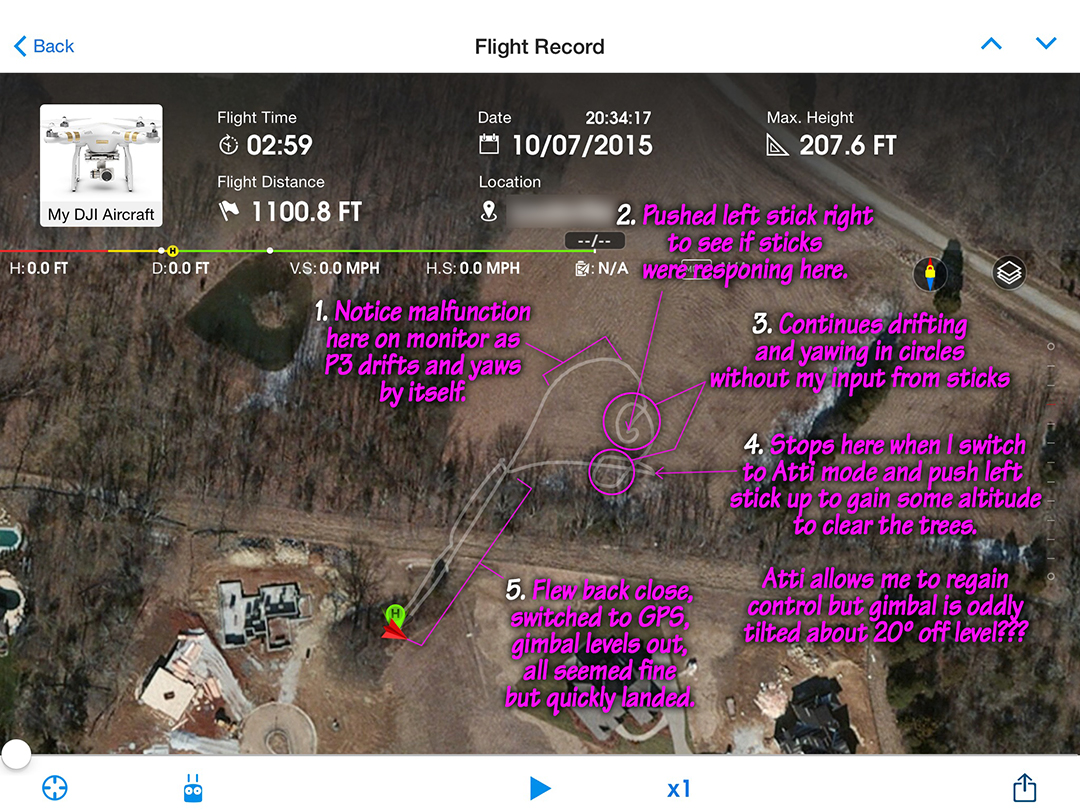

    I checked the fight within the Pilot App to confirm my stick movement and more importantly my LACK of stick movement while it did it's little walk about in the air. Pict attached with notes...

    It appears, to me, once you flew past those trees below waypoint 1 your aircraft starts to lose control. It isn't until you return to waypoint 5 where you did your atti-gps switch-over and gps started working. I'm leaning towards the gps malfunctioning.. I see the trees are missing there as if they have been cut down. Perhaps they are building something there, something underground? The map we see, is it up to date, or has some sort of development taken place? Or maybe it was a very heavy cloud? Have you tried flying at the exact same spot again?

    This is an old satellite map photo. The tree line is full and lush. The construction there are finished houses now. It's my backyard. So with two P2's and a P3P I've probably taken of from the exact spot hundreds of times with not one issue. Tried two more very low and close tests after this... no problems at all. GPS worked fine, craft hovered and stopped on a dime. Nutty. And makes me nuts! I'm just glad it was so close and I maintain a LOS. Switching to ATTI stopped the "issue" but it took a few seconds of moving sticks for me to visually orient myself to know which way I was facing. Tonight I learned seconds can be precious!

    Did the gimbal horizon go bad at the same time it started circling? Loss of control and circling is usually TBE. Switching to ATTI removes the compass and GPS which is where the conflict lies.
    Most likely bad compass calibration and/or magnetized take-off point.
