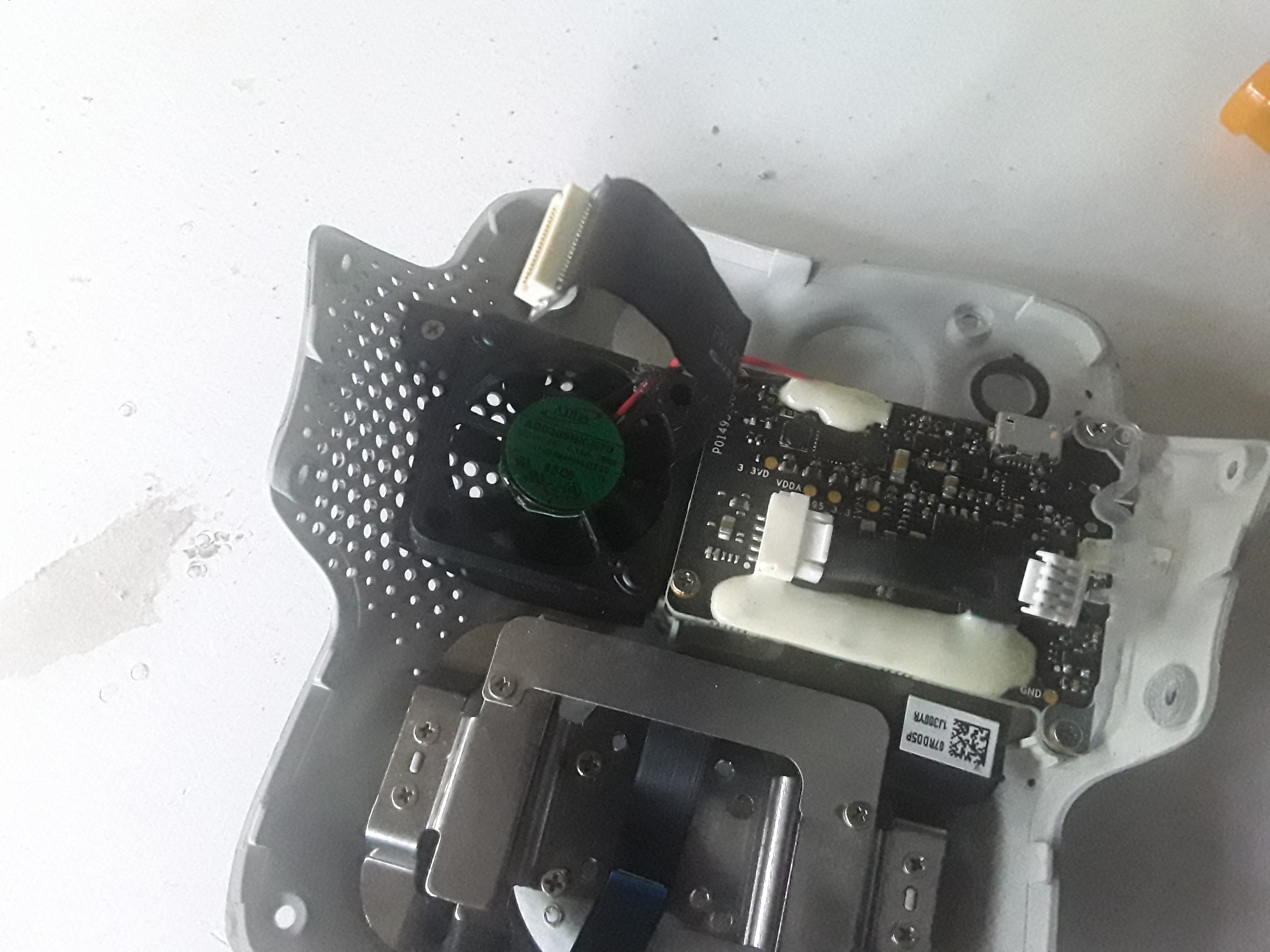

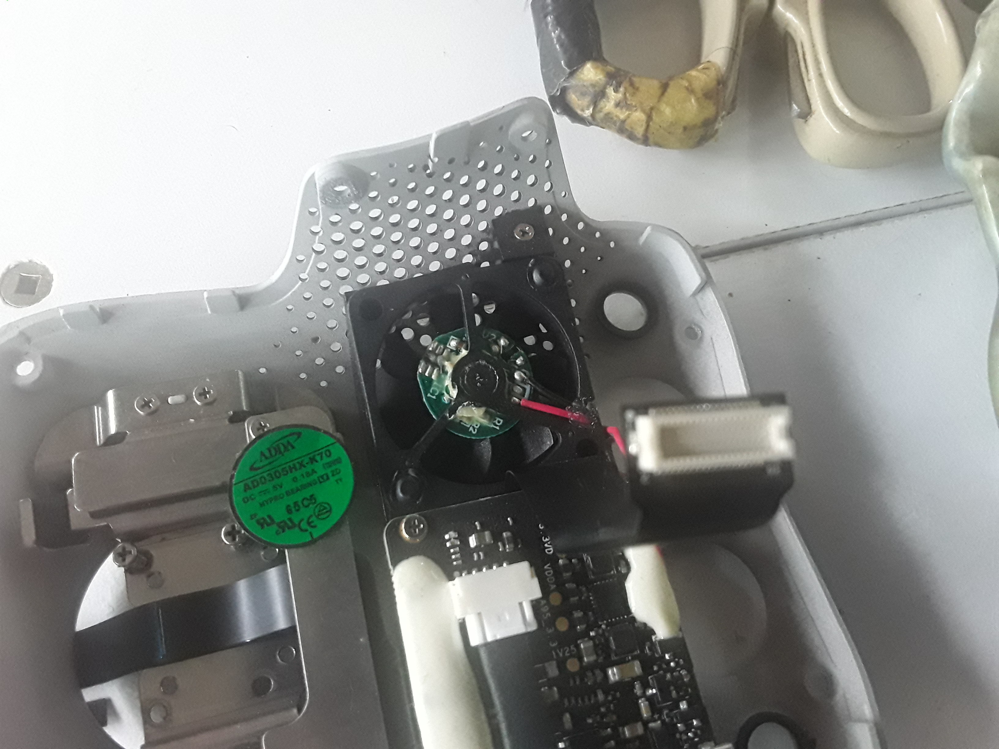

Yip should first hear fan on power up,that's it self test,,this inside one of me p4s,,this complete gimble unit with cam comes off very easy and fan right there,you could check where it goes onto board,if smell burnt might need new board,if looks ok and fan spin nice and free,I would remove or poke pin into wire and join wires from small batt to pins in wire to test it working,,,it's normal for it to start and stop but if no self test on start up this what I would tryThe fan in my P4A stops/starts alot and sometimes doesn't run at all. Is this normal due to a thermostat or something, or is it faulty and needs to be running full time?
