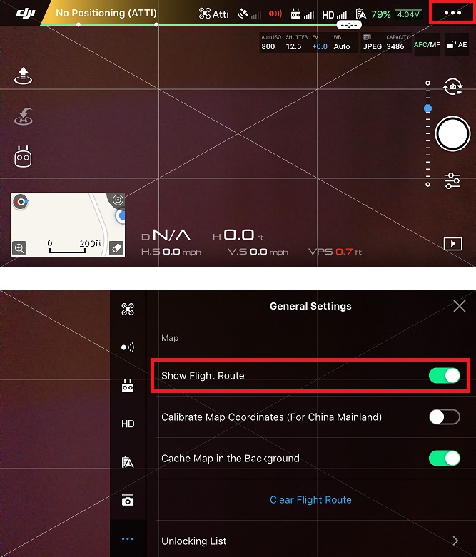

i updated to the new ,DJI GO 4.1.3 app i notice on the map the green line that connected the AC to H (home) is missing do need to something . i can't figure was going on..... and it was very helpfull if you fly in map mode just locate the green line and ET go home....

Have you checked your settings after the update? May have reset to Calibrate Map Settings for mainland China? I lost my map settings due to that and frequent insufficient data to load maps for some strange reason.
Are you referring to the flight route? If so, you can enable that setting in the following section of DJI GO:
