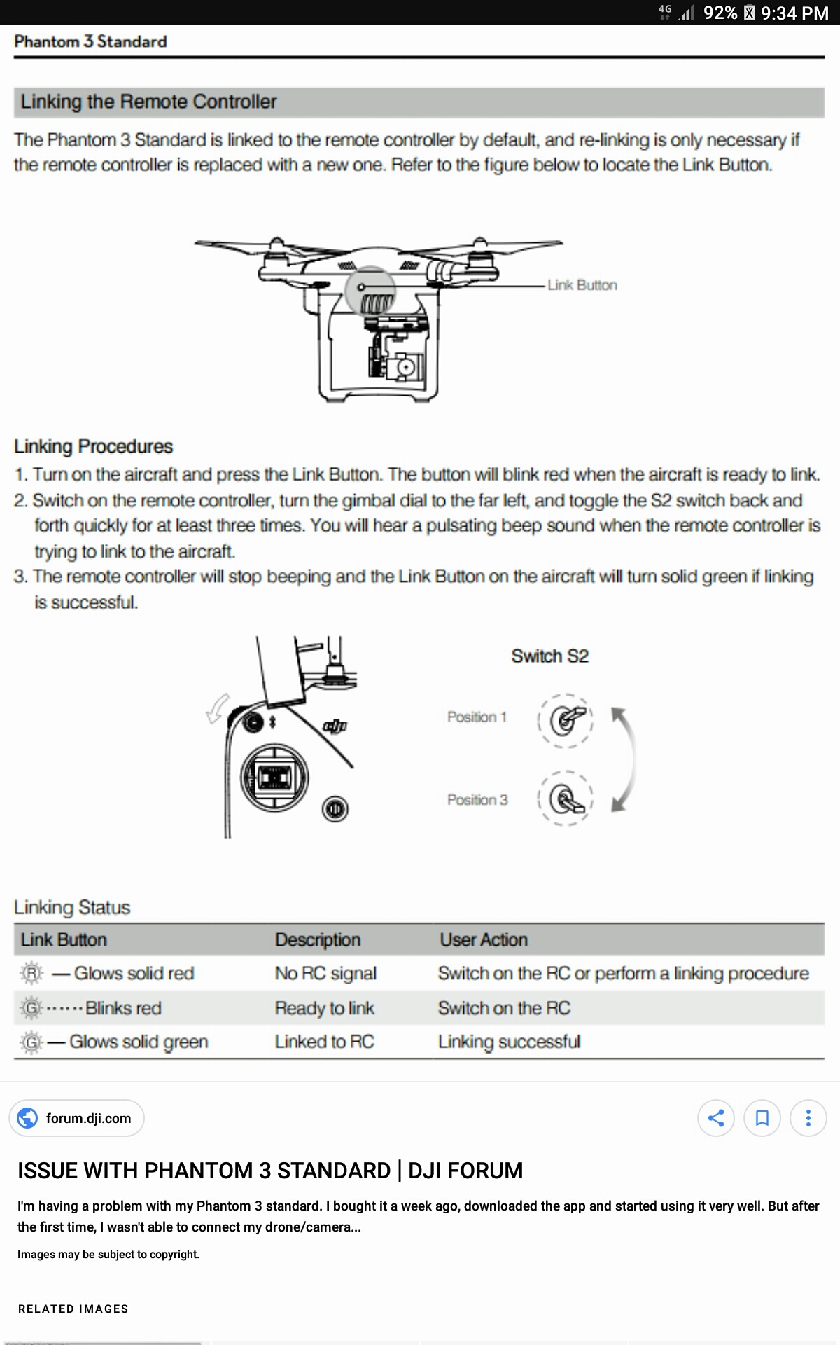

So please forgive me if this is in the wrong place. I'm very rattled right now! lol
So I'm trying to use my phantom 3 standard after a firmware update and it won't link up. The remote is beeping continuously a red light. Any ideas what's going on and how to fix it?
Have you tried the normal link process?
Also, have you done an RC calibration? What versions of FW did you have on your RC and AC before and after you made changes?
Right place....this manual link without app if can't do with app,,,,,,,,and welcome from NZ
