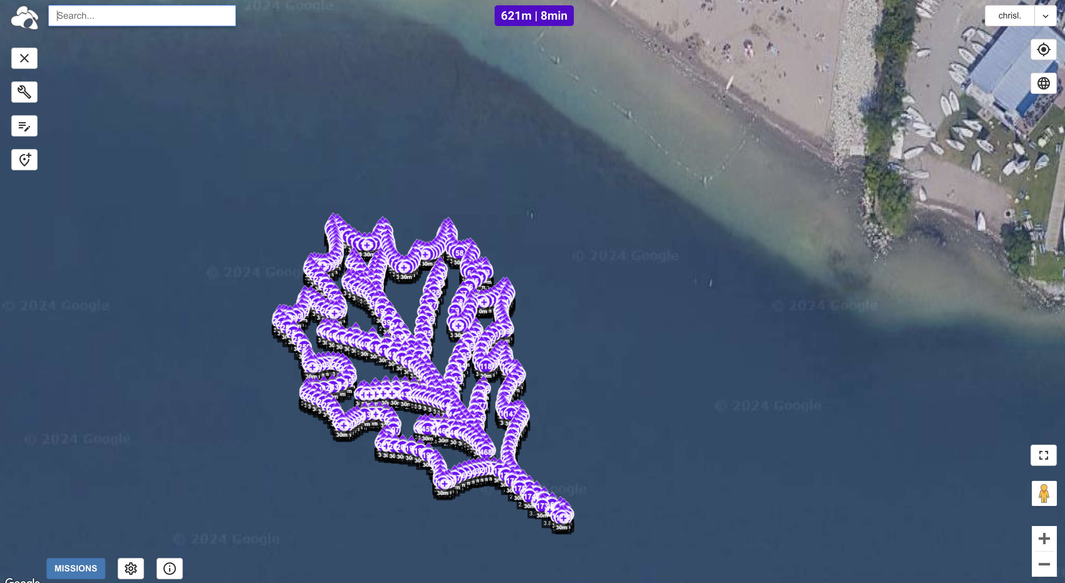

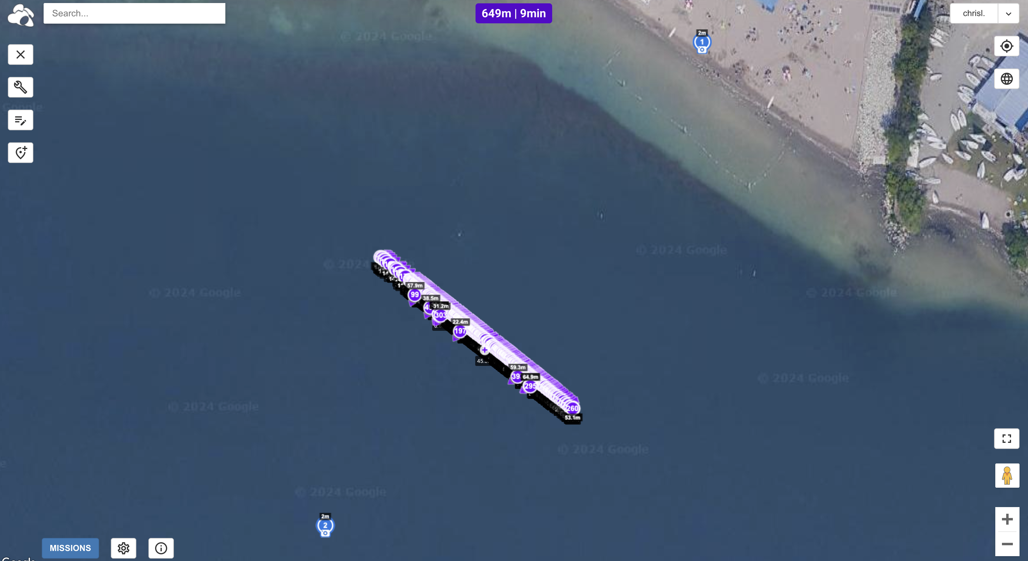

Below are a couple more light paintings done with my old Phantom 3 Standard last night. It amazes me what I can do with this old drone using Litchi and @DJ Wes's Mission utilities. I have included two screen shots of an oak leaf to show what the waypoints mission looks like before it is rotated (horizontal plane) and then after it is rotated in the vertical plane. The POI #1 is the approximate location of where my DSLR is placed to do a long exposure while the drone flies the waypoint mission in the vertical plane.

The flat version of the oak leaf:
The rotated version:
