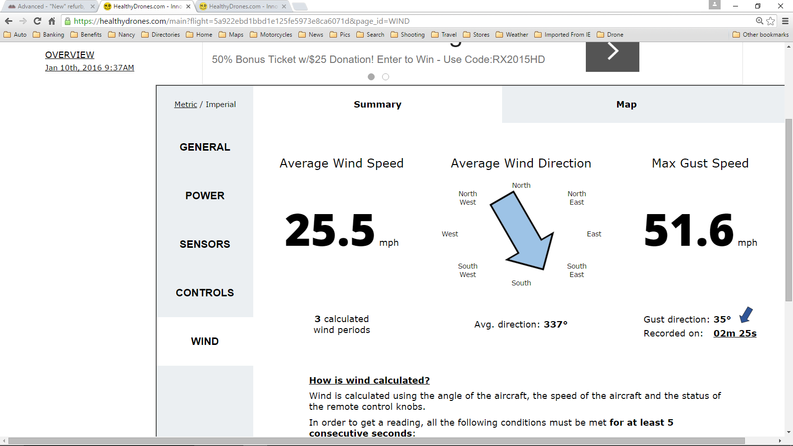

Wind
Wind Speed 12 mph (SW)
Max Wind Speed 20 mph
Max Gust Speed 29 mph
Visibility 10 miles

Flying in winds of that speed was asking for it. The prognosis seems simple - it blew away. 29 at ground level can mean 35+ at 100 feet.

I don't know why but it never enters P-GPS mode. The home point is set, but it's flown in P-Opti mode, bouncing to P-Atti mode. With no GPS lock, it doesn't know where to return home when the RTH is sent. It seems very windy as well to drift 10M/S? It also seems the right stick commands were not influencing the P3, probably due to the wind. The altitude and yaw commands were working, but are less affected by the wind. The end of the flight before the crash was at -4 meters. Not being in P-GPS mode will definitely keep an un-experienced pilot very busy. The mystery here is why the P3 never entered P-GPS mode?
