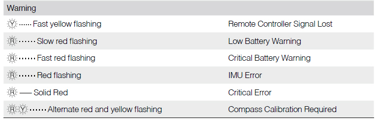

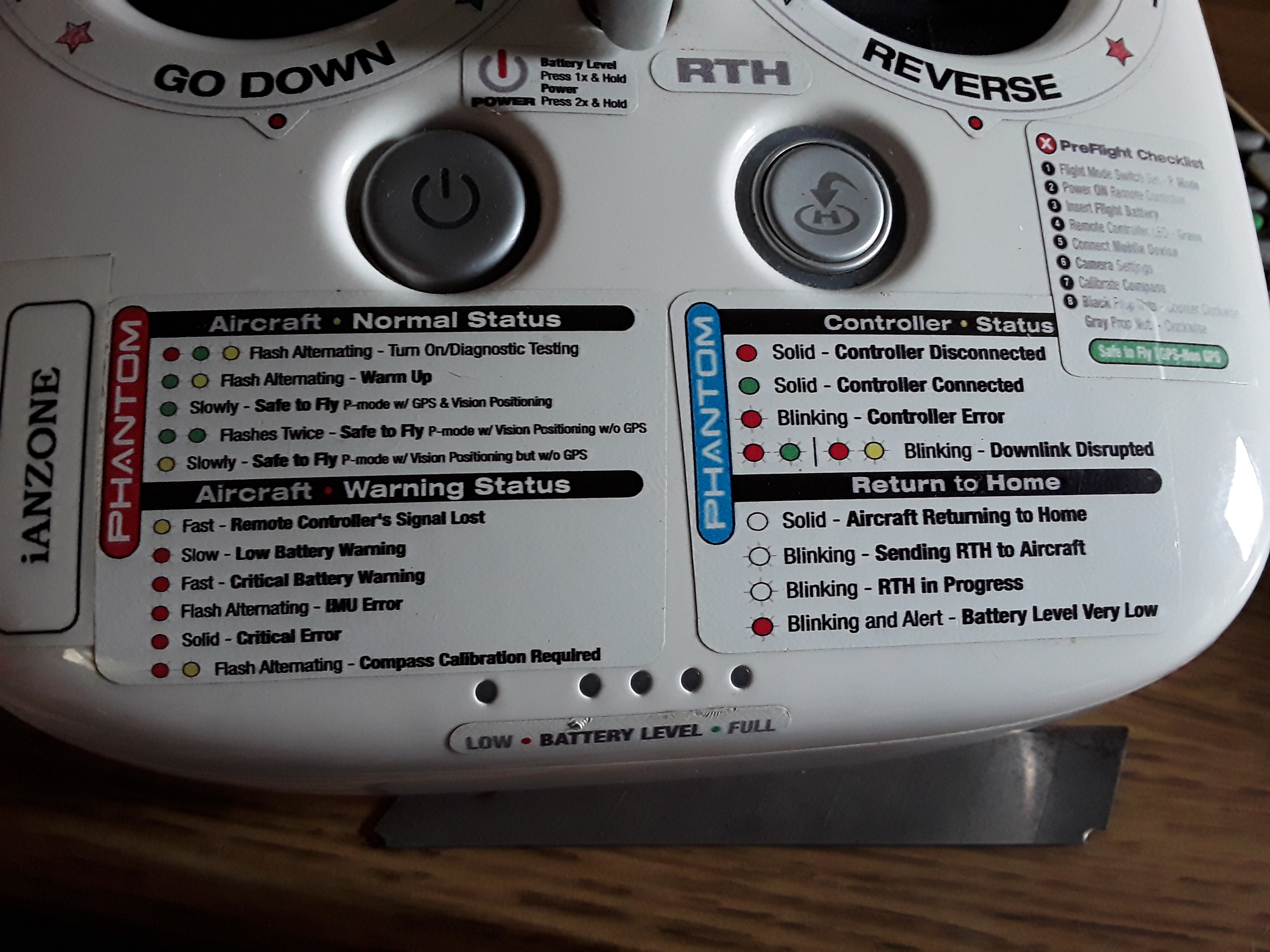

Tried relinking,might have to do manual link , unsure why not start without app,yes try get aircraft status, my light chart says red and yellow is compass,
I have solid red leds on aircraft so it is a critical error? will just send it back hopefully get refund soon and order from other dji vendor not this one again.
