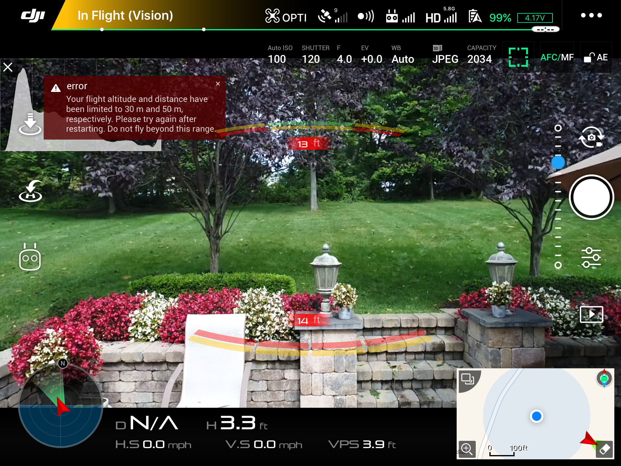

Sorry for the delayed reply guys. Here's what I have...
Btw... I also noticed that my gimbal is panned a few degrees to the left. Hmmm..
Is anyone able to give some insight on the "error" in the above screenshot? I have only been able to take flight from my house as I haven't had the chance to go anywhere else yet. Hence, I do not know if the error appears when launching from a different location.
Thank you!
Thank you!
Did you log into DJI from the DJI Go 4 App, before connecting to the P4P? This looks like the new limitation they created which forces you to log into DJI, although I'm not certain.
Related to your tip... Does the app log me out when I close it? If not, maybe that is what I need to do. Force log out, and then back in.
As far as I know, you only need to log-in once after the latest firmware update.
