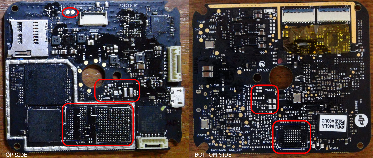

The p3a is missing the chips highlighted, which is why the feed is limited to 2mbps and 4K is not an option on the advanced

My Advanced gimbal assy is out of commission awaiting a new cable. So meanwhile, here is the 'video card' inside the gimbal box.
Compared to the Pro there are components missing from the underside of the board too.
The board itself seems identical, including solder pads for the fan. But the Pro has lots more circuitry.

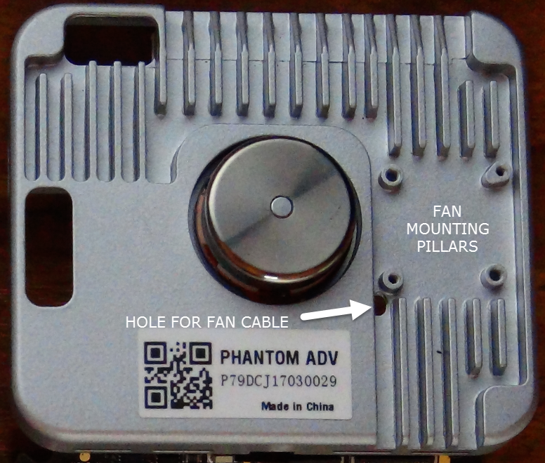

Incidentally the upper case is also identical. The Advanced even has the hole drilled for the fan cable!

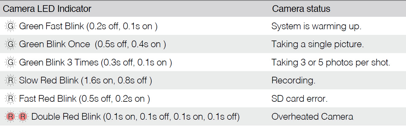

Latest on my Pro camera on P3A:
I put a 64Gb SD card in so I could video beyond 30 minutes and extend my "does the fan ever come on" test..
Last time when I got close to 30 minutes the 16Gb card filled up and the recording light changed from single flash to double flash.
And this time it did just the same! So I looked up that double flash in the manual.
Duh. I should have looked at that earlier. I am now interpreting that status message as "Overheated video card". As far as I can feel, the heat doesn't get all the way down to the camera module itself.
If the gimbal overheats I believe a warning message is sent to the controller device. But not if the video card overheats, as far as I can see.
And nothing else seems to happen. It doesn't shut down the recording which is causing the overheating.
Anyway I think that I can finally conclude that the fan is definitely not working on this Pro camera on my P3A.
And if anyone else who has put a Pro camera on a P3 happens to see that double blink after extended 4k recording, then I suspect they have the same problem. No fan control.

Some users have commented that the fan is only held on by two screws.
The reason could be that the holes in the casing are two different sizes.
In fact I noticed that the screws in mine were loose to the touch.
I found they were designed for the smaller pair of holes but were fitted to the larger holes.
And without any studlock to retain them either.

Are the larger holes threaded? Those two posts may just be standoffs so whem mounted with two srews the fan housing doesnt warp towards the case when mounted or just general support. They wouldnt create a tool path in production for different thread sizes witjout good reason and using two different sized fasteners in that application makes no sense.
One thing for sure that is one TEENSY little fan!
