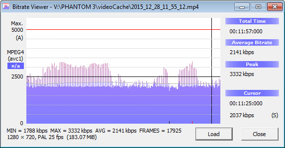

So here is a little more on the video stream bitrates.
There is a neat little free PC app simply called Bitrate Viewer. If you drag a video file onto its window it does this.
So that is a typical example of P3A video rate connected to a EU iPad, sending 25 fps at a little over the reported 2kbps.

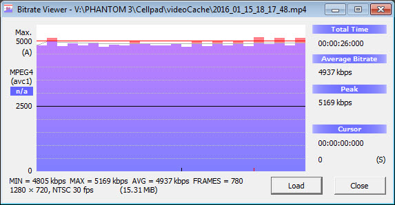

Then I swapped for a P3P Camera.
Recording in the home I got the following bitrate when connected to the same EU iPad.
As I noted in another post, the frame rate changes to NTS 30fps and the bitrate increases to 5k.

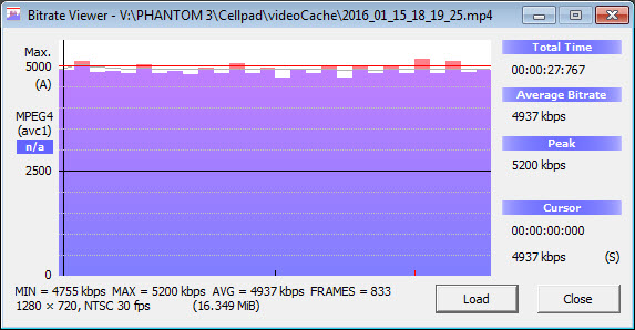

Switching iPad location to US (and leaving at Auto bitrate) gives no change:

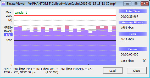

Selecting Custom and the minimum 4Mbps gives this:
So thats nowhere near 4Mbps. Much worse than P3A.

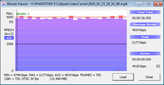

And finally setting to the Max of 10Mbps:
That is only half of what the slider says. Its just the same as Auto.
And this is with the controller within 1 metre of the static craft, so nothing to do with the distance or transmission quality.
I panned the gimbal wheel up and down during the recording to make sure there was lots of video data to transfer.
And there is some pixelation of the image even at "10Mbps", so it should have been trying its best to maximise the bitrate.

1 frame phantom 3 adv = 8 Kbytes / 8Koctet
1 frame phantom 3 pro = 19.5 Kbytes/ 19.5 Koctet
hummm c'est bizzard.

the bytrate is now 5,5mbps (2,0mbps max for Adv)

this is P3 advanced max quality in live
and this is the same P3 with my new camera PRO max quality!

Now I wait to see if you can really get a 10Mbs live feed. Mine never goes above 6Mbps however I set the slider.
