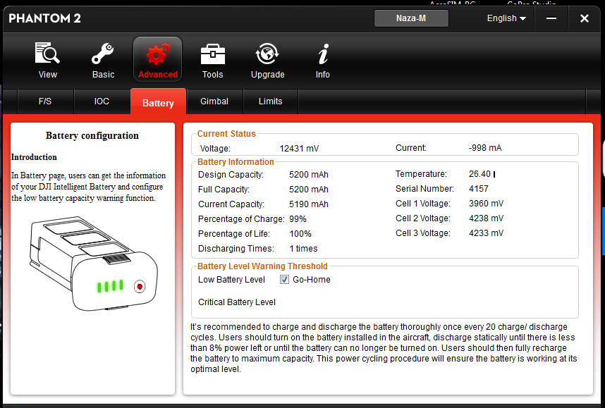

Hey Guys. New battery today charget it second time and connected to computer and as You can see 1 cell is low voltage. What do You think can i use or some how discharge-charge repair it or this is just permanent fault ??

That's only a close indicator of the batteries cell condition. If it were mine I wouldn't worry about it.
Yes but always when i read about lipos ewerybody says they should be well balanced and so on. I watch couple of videos os crashes and then people says that lipo was not balanced so i start wooried. The phantom fly well dont give me any alarms or something. All my other batteries are spot on with voltage only that one is like that.
Another thing is the battery voltage. 4,23v wchich in my opinion is a little to high don't You think ??

If the information you are reading came from the battery manufacture fine but what information you are reading in these forums is coming from so called experts in battery technology. Most of those problems with lipos going up in flames is from over charging with either faulty chargers or units not authorized by the manufactures.

No i wouldn't consider 4,23 v to be to high. Mine fully charged are 4.201v but these are 9 months old.

i believe battery manufacturer don't say much about voltages and any of that;s stuff that's typically electronic related. This product is designed to just plug charger and charge for people qho don't need or want to understand of that's electronic.

I wrote to DJI support because my regional dealer won't answering to my email and in return they say that i should return battery for replacement and not fly using that battery anymore.

You'll be lucky if you ever here from DJI. Personally I would be out flying with that battery but then I'm not you. Look more then half of what read you about batteries in these forums come from people with every little technical background in battery technology and it's mainly hearsay. Problems about batteries catching fire are due to over charging or damaging those batteries. An for sure I'll catch flack for voicing my opinion but that's life.
