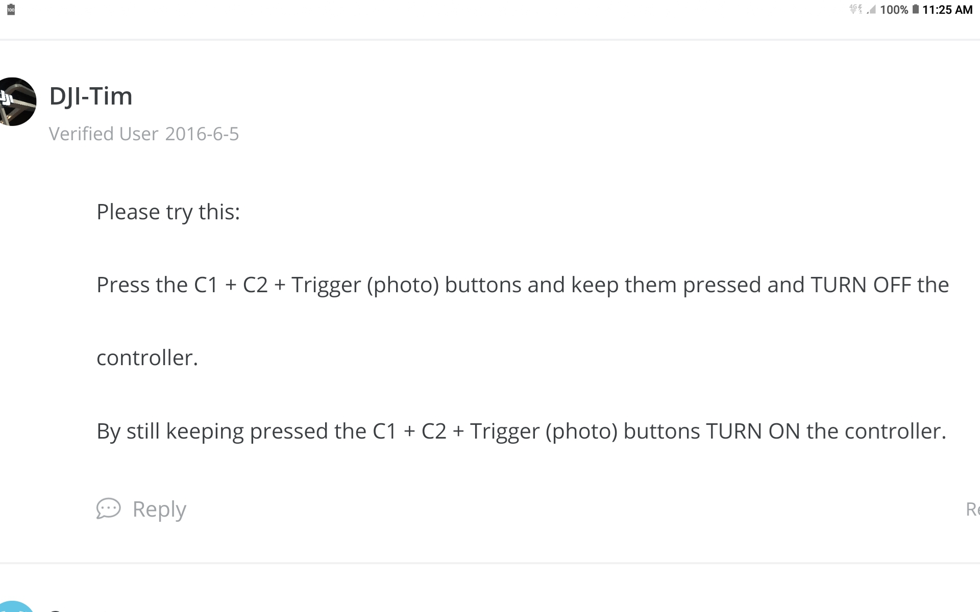

See if this does anything,,it was in some replys of logo stuck onscreen,I think its controller reset

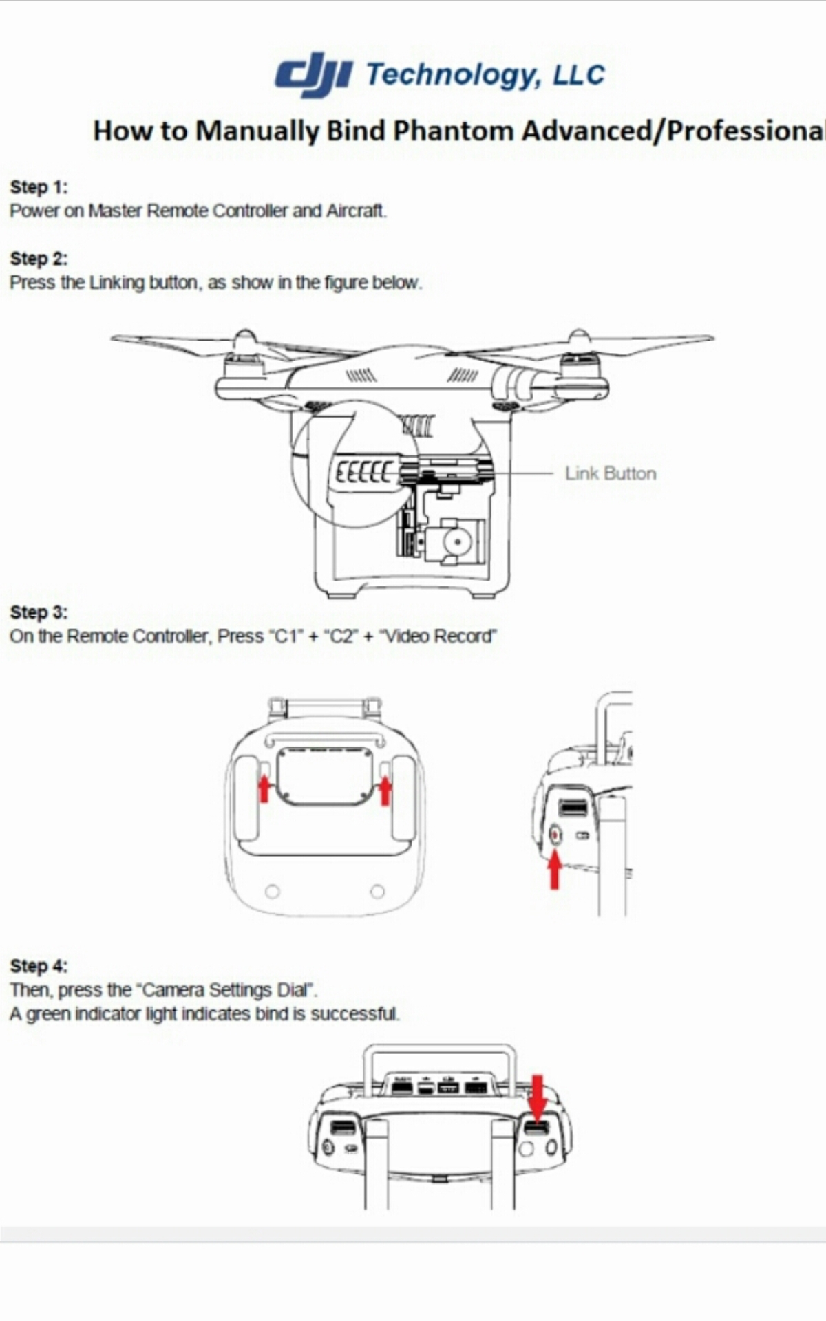

Can you open app to relink ? If not manual link as below
Ok... update... now have green light on Rc but still no feed.. just the dji logo

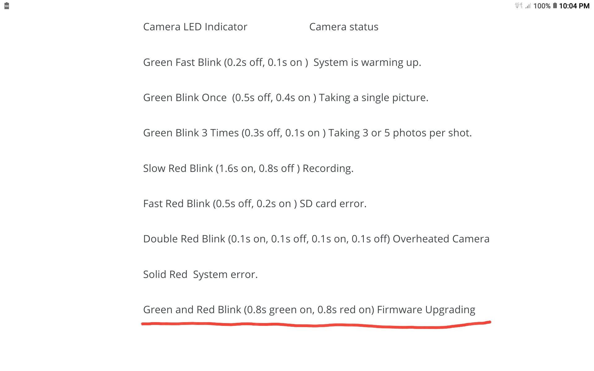

Led on front of gimbal flashing green and red so suspect connection from gimbal to the other board ofdb? Which is that and where is it located
Red and green on this light chart,,,mayby the firmware update failed,,?has me unsure

Hope you had a fan blowing air on the gimbal as it was trying to update. Maybe overheated the gimbal board. As mentioned above, flashing red and green light on gimbal means it’s updating.
The pro has its own fan, surely a drone of this price doesn’t need a fan blowing on it just to update software ????!!!!!!
I wouldn’t have said it if it wasn’t important. The little fan on the gimbal is worthless. There are MANY POSTS on this forum that backs up what I wrote. I have worked on many 3 pro cameras specifically for the reason of overheating during updates. Do a search about no video feed on P3P cameras on this forum,,, then let me know what you find out!
