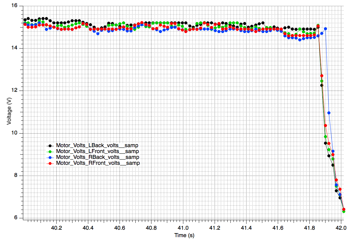

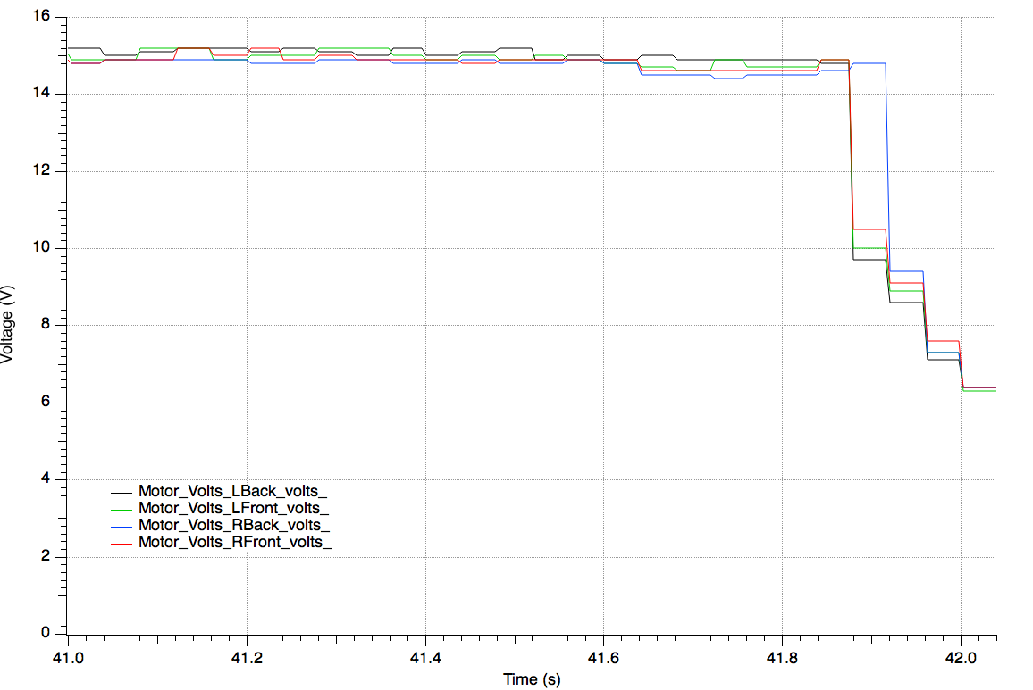

This was abrupt power failure at 38.8 seconds - either a board connection failure or a battery disconnect - most likely the latter since it appears that it rebooted when it crashed. The .DAT files (there should be 2 if there was a reboot) will confirm either way.
Thanks. I'm trying to figure out the dat files now. It was still powered of when I retrieved it (though upside down and in several pieces), so the battery was still in and supplying power. A board connection failure certainly sounds possible. This is the first crash or even hard landing with this drone, but that might make sense.
There seem to be 6 files for that afternoon, though DJI Assistant is displaying "Save To Local (9)" when I add them all. It keeps getting almost done and then losing the connection...which perhaps also points to some kind of connection failure. I'll keep trying to get them posted or look for another way.
I've uploaded a dat file to dropbox. I wasn't sure which to use from that afternoon, so there are a few there.
Dropbox - DJI_ASSISTANT_EXPORT_FILE_2018-03-04_02-59-38.DAT
OK - the flight file was DAT360, and it shows power interrupted at offset time 41.875 s. After the crash it did reboot with DAT361. There is no way to determine the cause of the interrupt but, since it rebooted after the crash, a bad battery connection seems most likely.

I don't think it has anything to do with the software or firmware - these are physical power interrupts. In past events they have been caused either by an incorrectly seated battery becoming dislodged or by solder joints on the main board power connection failing. The former seems to be more common than the latter.

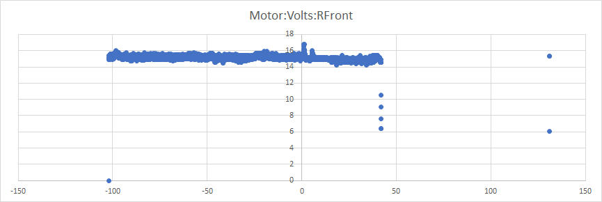

This one also exhibits that the .DAT file wasn't allowed to close properly because of the abrupt power loss or crash. Just like
Mystery Crash P4 flewn with Litschi
which was also a P4 Pro
This time I used 3.2.0, which is presumably why I didn't see the additional spurious data?
Yes, that would be my bad:). The "feature" that allows the spurious data to be shown has been in and out of DatCon a couple of times. It's nice to have, but, it can cause people to think DatCon is broken. Also, including the feature required fixing some corner cases. Anyway, it will be included in DatCon 3.3.0. I'm thinking better to have it than not.
What did you think of my Excel plot? Sometimes CsvView just doesn't make it.
