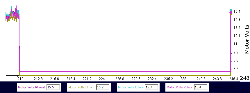

That's the one. A quick glance indicates a significant power failure at around 210 s, leading to very low motor voltage and interrupted data logging. Strangely the logging resumes at 246 s, but only for around 1/10th of a second. This is going to need a bit more analysis. Do you have the Litchi flight log?
... Strangely the logging resumes at 246 s, but only for around 1/10th of a second. .....
I think I know what happened. But first, you have to tell me how you got the last little but at 246 secs. :)

As @BudWalker mentioned - that appears to have been an artifact of the DatCon version that I used (2.6.9) and is not real, but he is checking it out. The log almost certainly ends at 210 s and does look like a battery disconnect.
That log data at time 246 secs are from a different previous flight.

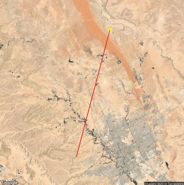

The .DAT file is written in blocks - just like in a normal file system. Records are written into a block until the block is full. At that point the block is "closed" and future records start being written into a new block. When a .DAT file is deleted it's blocks are then made available to be used in a new .DAT file. When the last record of the log is written to the .DAT file the location of the last byte is recorded within the block. If that didn't happen then it looks like there are extra records - past the last record that was actually written. The bytes for those extra bogus records are whatever was in that block from the last time the block was used in a file.
That's what happened here. There was an abrupt power loss or crash and the current block didn't get closed. The extra bogus records where from a previous flight. The incident flight had a last recorded position of 46.64057343 25.19290684 while the next bogus position was 46.48202829 24.65086564. Shown here as the ends of the red line
Also, looking at the GPS info in the bogus records it's possible to see the previous flight occurred 2017-11-20 11:25:41 GMT
Note, also, that it "appears" that the motorVolts recovered from having dropped to the 7 volt range. But, those values came from the previous flight.
It may be worth reiterating that although the graph above shows voltage traces between 210 and 246, there are no actual data points in that interval. The data logging stops at 210 s when the voltage drops below around 7 V or so - pretty much identical to what we see on other battery disconnect or sudden power failure events.
