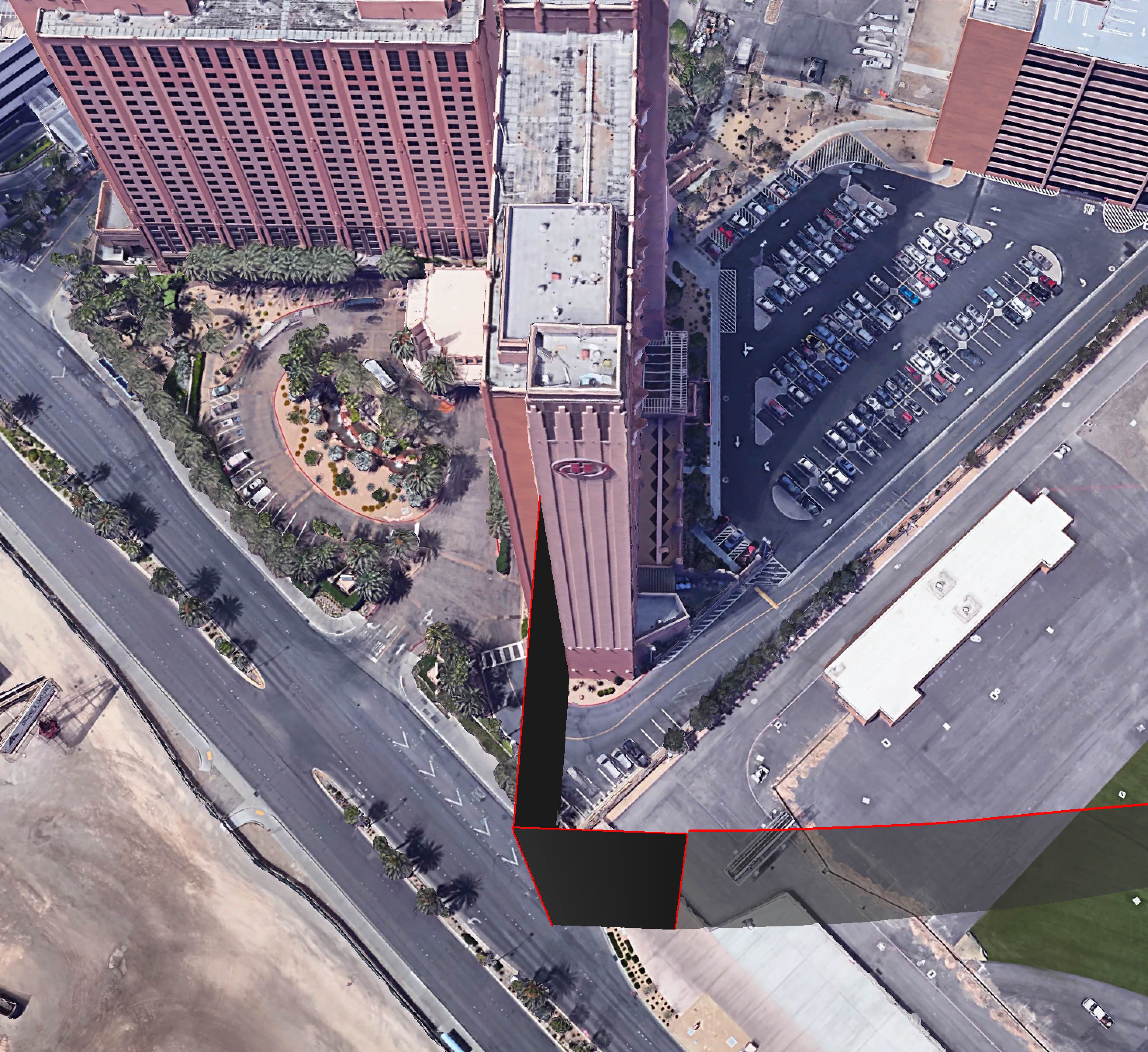

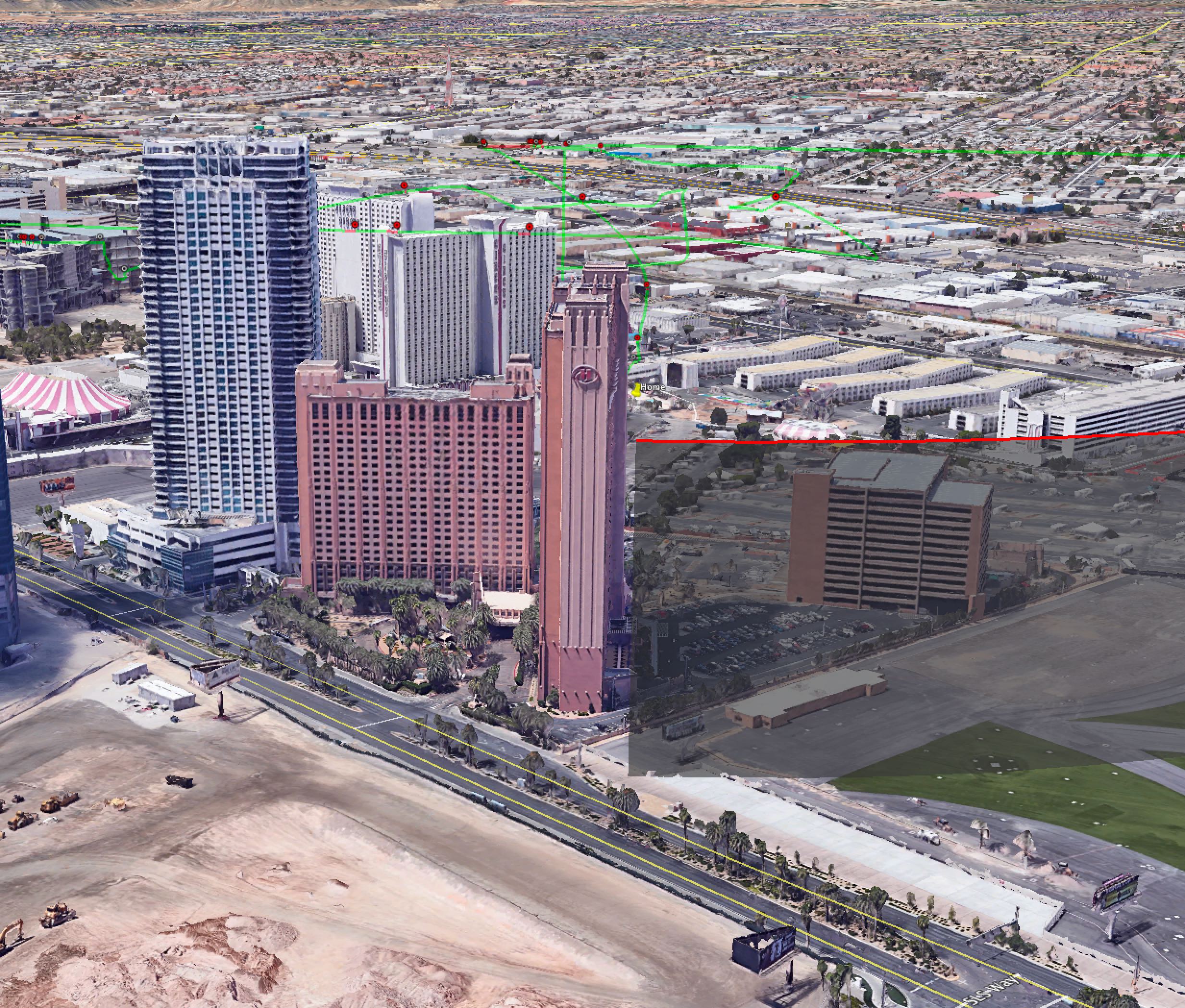

As pointed out above, it's no surprise that it disconnected - at an altitude AGL of 300 ft it flew behind a building that is 380 ft high:
If it continued at 15 mph for 3 seconds (66 ft) it would have been directly behind that building when it attempted to RTH and, since it was already above its RTH height of 98 ft it would not have cleared it. I would expect it to have auto-landed at the end of that building:

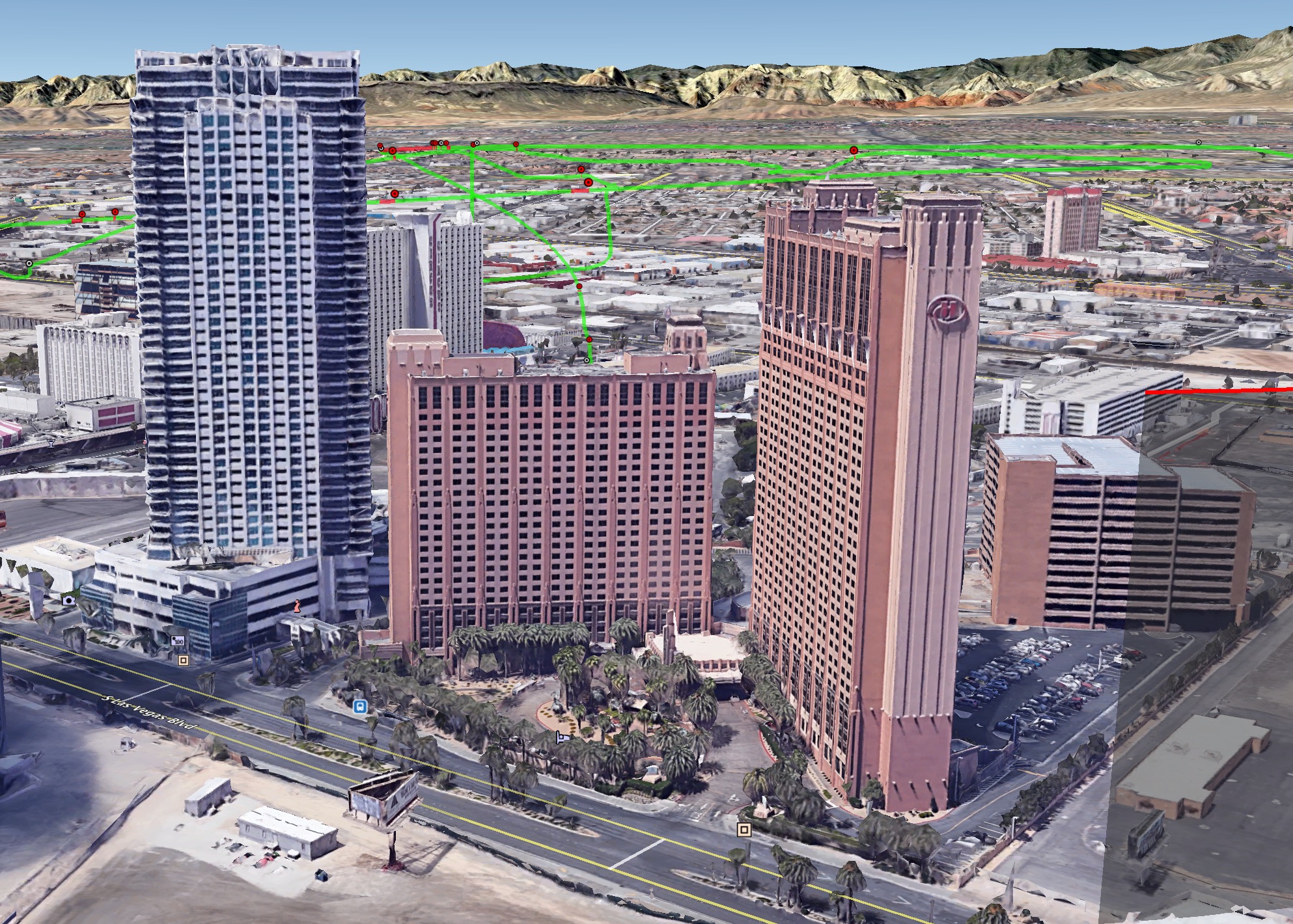

There is another possibility. You mentioned that winds were calm, but that does not appear to be the case 300 ft AGL, where there was clearly a fairly strong wind from the north. AirData estimates it to have been in the 20 - 25 mph range and that looks consistent with the pitch, roll and yaw data for a couple of periods during the flight when the aircraft was stationary. Given that wind vector, the aircraft may have been blown further south than the direct line back to the home point. It should have cleared the lower Hilton building immediately adjacent to the taller building, but it would not have cleared the grey condo tower to the south of that. That may be worth checking too.
