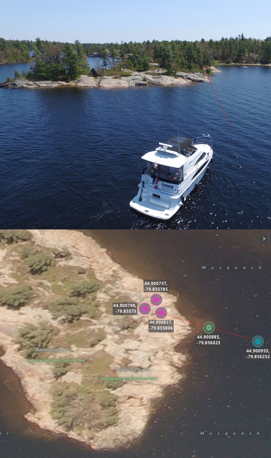

Bing Maps have a much more detailed view of the area ....
The stop of forward motion and bounce upward would also lend credence to hitting the leading edge of that rock.

Thanks Mike, bear in mind though that when that picture above the boat was taken, the Phantom was at a much higher altitude. After that picture was taken, I flew it around behind the boat and I was bringing it in to land so it wasn't that high above the boat when the auto RTH engaged.
both the GPS altitude and baro altitude say that the 12G deceleration (our assumed crash) occurred at the same altitude as the photo was taken (within 10 feet).
not true
photo was taken at 16:51:12.230 (flightTime/offsetTime 925.3)
at that time bird was 14 m higher than in the moment of crash
Yes -- I took a look at Bing's map too. It's still a poor image and I'm not sure when it was last updated. Here's an interesting look at it though:
I just don't understand how/why his interpretation of the logs differ from my recollection of what happened.
Like I said a few times now, I'm simply telling you what the logs show.
The location of your line in the photograph is quite a bit off though. If you look closely you will see three people in the photo. Two adults and a child. Those are my friends who fished it from the water seconds after impact before it sank into the bay. The rock that it hit is directly in front of where they are standing.
The tree theory is also based on the 40' fall in altitude. There are no 40+' trees anywhere near the crash site. Hitting one of those shrubs near the water would have been much better !
That line was just my estimation based on your photo. The Bing photo is pretty lousy, so I did my best to visually line it up based on the shape of the land.
