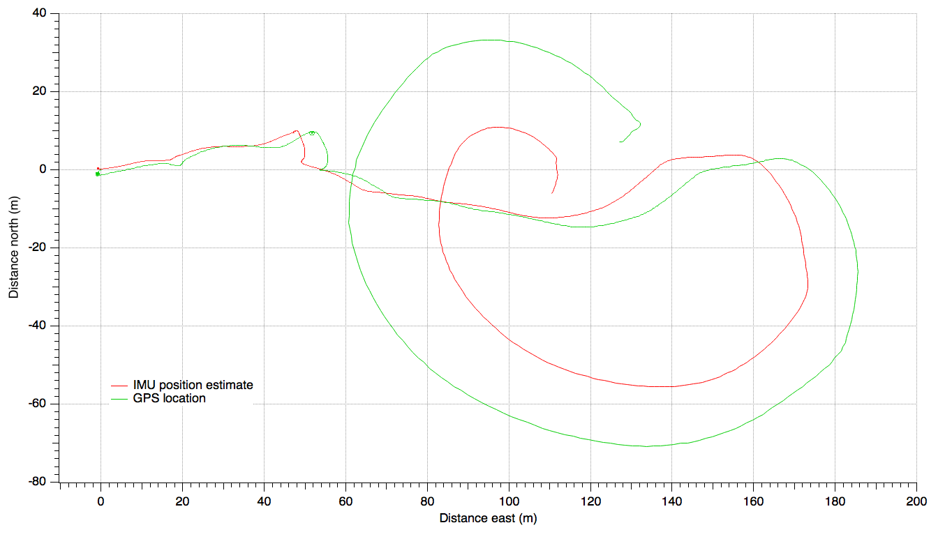

You were in P-GPS mode, also known as GPS-Atti mode, not ATTI mode. That means that the FC is attempting to control the aircraft location - holding position when sticks are centered or holding track according to heading and elevator/aileron inputs. So it is combined pilot/FC control.
The compass error affects the FC control because the FC has incorrect information on the aircraft heading, and so corrections to maintain position or heading don't have the expected outcome - it applies thrust in the wrong direction.
Depending on the magnitude of the compass error, that can result in various uncontrolled flight patterns, including the toilet bowl spiral that you observed. The error also shows up clearly in the increasing discrepancy between the IMU-computed position vs. the actual GPS location as the flight progresses:
If you switch to ATTI mode then the FC stops trying to correct and the problem goes away - you are just left with the problem of correcting for wind-induced drift yourself and, of course, dealing with the different flight characteristics of ATTI mode.
The best way to ensure that this doesn't happen is to check that the aircraft orientation arrow on the map at takeoff is pointing in the same direction as the actual aircraft orientation. In this case the arrow will have been pointing around 30° south of the actual orientation, which was around NE.
