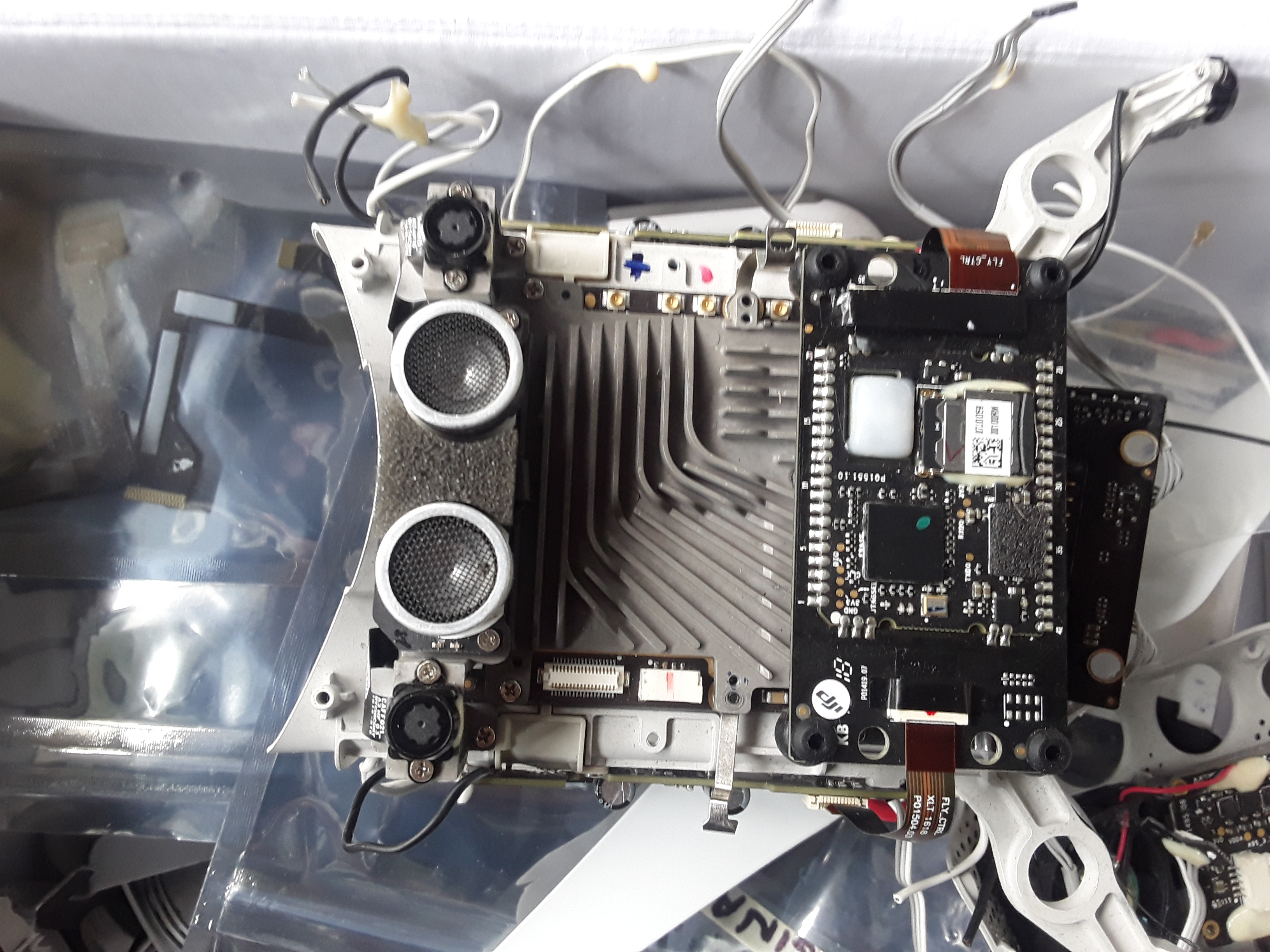

Yip try airplane mode,,uumm just to be clear are you getting this from your tablet or drone,what the status of aircraft on start up,,I ask this because after a p4 I had freefalled to its death when I powered that back up it had that prompt aswell and that part inside drone was very hot,it was that big alloy part what ever that processor called,hopefully it's not what I show and is tablet overheating

It's the drone processor. When I take the battery out I can feel the heat on each side of the battery enclosure. I don't hear a fan turning on. On start up, it's ok. After about 3 minutes flight time I get these messages. the big allow thing is the heat sink.
