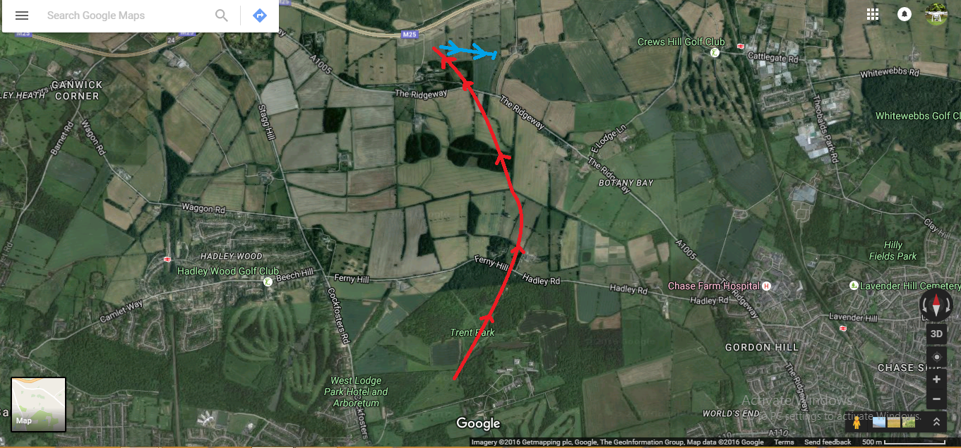

My DJI P3A Flew away just now :( what to do?
it is showing it was travelling to me but it is up to GPS signal problem, after the GPS signal problem AC shows it is towards to me but actually it is travelling to the opposite direction with high speed.
i tried to draw its possible direction on the map after the GPS signal lost. This is my possibility 1.
I need another drone to find it :(:(
If the battery died at the video transmission cut point. it should be around here. farming fields are there and crops are 60cm tall :(

I did it yesterday, I checked around and I was hoping to get signal but no luck.
I will post signs around but as you may see from the area (trent park, enfield, london) it is a huge area with many trees.
If you can see from the video, after last point, flight distance is increasing too much as the drone is going to the other way.
So if you believe the telemetry data in the flight replay, it traveled for about 4 minutes at about 25mph, or 40kph. That calculates to about 1.6miles (~2574m) away from the last recorded location. Does this jive with where you think it is?

It was 35% when I brought it back close to me but suddenly GPS signal lost and it started to drift to the opposite way with maximum speed.
It was 50 meter far from me but after loosing the GPS signal it went 3 km away and when the battery went to 12% video transmission lost.
A mode did not work, horizontal managing was not working.

I was having the video transmission till 12% then it is cut, and what I did, I told my wife to take video of my screen which she already did.
but after 12% battery I did not receive any video transmission. If it landed at the last seen place, it is in the middle of wheatfield, 60-70 cm tall crops are there.
I walked there but could not find.
I will visit the owner on the farm today, I am preparing some signs, lets see if they can find it but my question is they may cut the crops with a Farming equipment which may destroy my bird there.
if it travelled after 12%, i do not have any idea where it is.
it was not travelling straight, that is the problem. Let me visit the farming fields again. Lets see.

As for your aircraft, one positive thing is, with the aircraft being at 12% it was likely only a minute from beginning to descend at the 10% setting. By using google earth you should be able to come very close to where the aircraft is located.
You mentioned the a/c (aircraft) was drifting at the time of video loss. Use the line of travel and extend beyond point of video loss. You can then time the distance to drain under 2% and add that to the point of video loss. Take notice if there is any tree's or other obstacles along the drift path and take note of them.
You need to know that 2% battery will actually drain faster the closer it gets to being drained. So in other words, the a/c will drift less when draining down from 12% to 10% then say from 22% to 20%.
Except that we have no idea where the Phantom was or what speed and direction it was traveling for the four minutes before it hit 12%
Can you share if you remember roughly the amount of wind speed for that day?
Thanks for the advices.
Wind speed was 5-6 knots.
