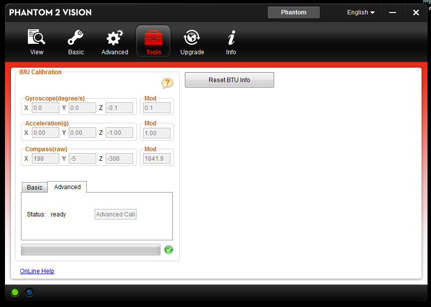

Otherwise use the assistant software to check the compass readings
Post a screen shot of what it shows

again use the assistant software to see what the compass is showing
I did now the calibration with the assistance software. It seemed to be ok

Haven’t you given up yet lol, the software is used to calibrate the IMU and the controller
