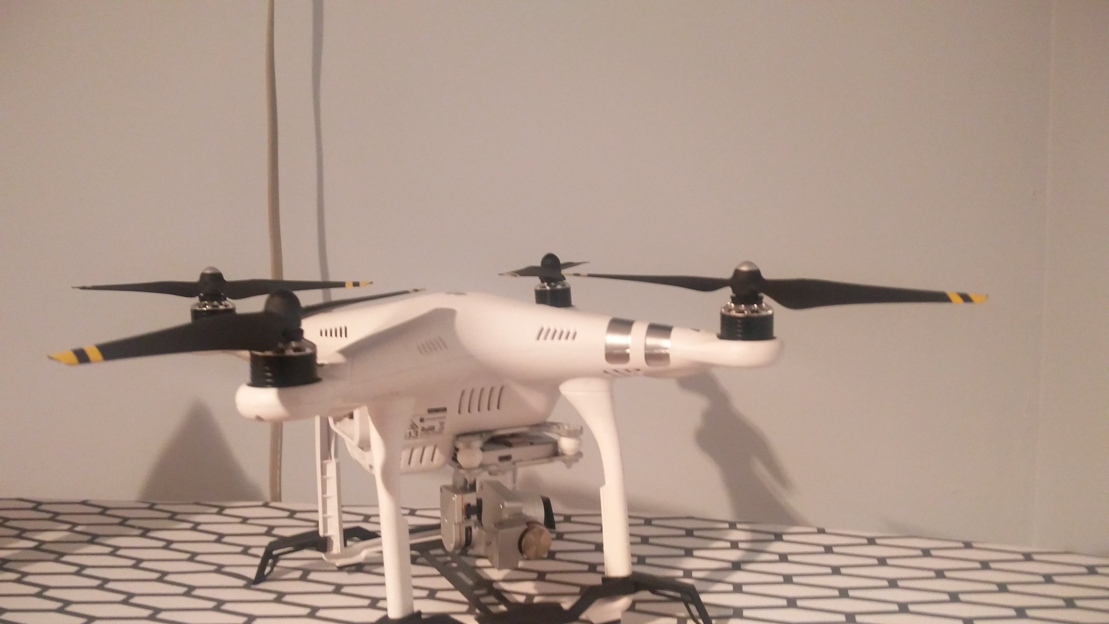

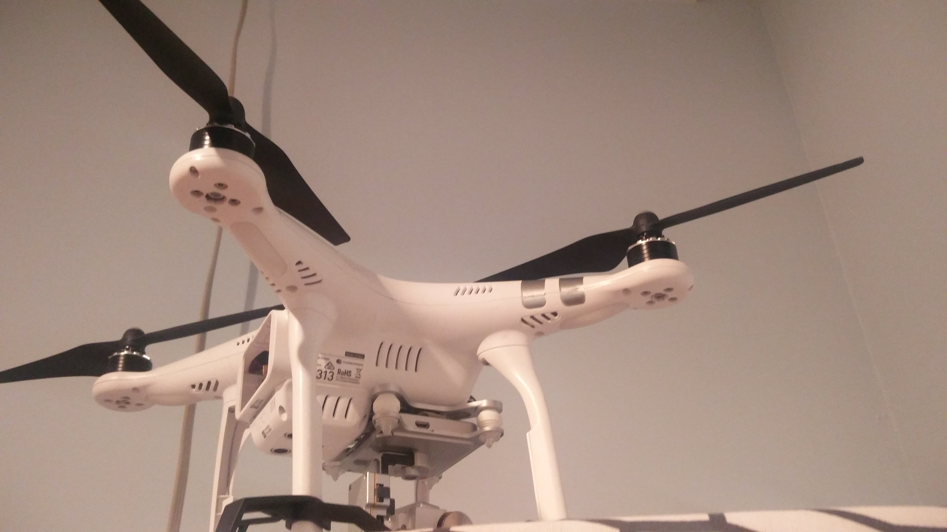

Hey guys got my p3a about a month ago, been loving it every day. I got the KDE motors about a week ago and so far very impressed. Definitely more agile, much quicker 0-35mph(is there a mod that unlocks top speed?). Going to do battery tests soon, haven't had the opportunity yet. Installation was more or less straightforward, they do not require any change in electronics or settings, unsolder 3 wires for each motor and solder matching wires for new motor. The only issue I ran into was when it came to mounting them, it seems dji modified the structure of the motor mount to add support but it is in the way of the new motor. Long story short I used my soldering iron to poke a hole through the center of the mount and an exacto to clean it up a bit(I was at home and eager otherwise I would've dremeled it at my shop). Considering the loss in support I opted to get a set of aluminum motor reinforcements. I flew it for a few days before the reinforcements came with no issues and same since they came. Haven't taken pics with them on yet will post those later. Also they sound great IMO.

Not to bag on you too badly (well.. just a little) these aircraft are smooth flying camera platforms. If you are interested in speed, agility, performance, etc, just purchase a racing drone.

As ''gklugie'' says - these are camera platforms and not racing machines.
Upgrade of motors for something like the Phantoms ?
If motor is more efficient in converting electrical energy to thrust - then OK
If motor is lighter and gives same or more thrust for same electrical energy as original - then OK
Upgrade must in my view improve the quality of flight of the model. But depending on the model the improvement desired changes. For a Phantom - I would be looking for smoother longer flight. For a racing drone - I would be looking for increased speed and agility.
So far with many years of playing with motors - I can honestly say the DJI motors are good compromise of budget price and performance. They would be hard to beat anywhere near the price tag. And that as we all know is a big surprise that DJI branded motors are budget priced (they are not made by DJI though).

There is a mod, I just did it and it's simple. digdat0/P3I1_FWProject

Upgrade can include more efficient motors, not necessarily faster ones.
"If it ain't broke, leave it alone" is my motto. In reality, what does one gain, more speed? Why do you need that? The Phantoms are sedate camera platforms not designed for racing!
You don't even get more speed.
The motor speed is controlled by the flight controller in response to joystick inputs and sensor data
But speed doesn't come from the motors spinning faster.
If the motors did spin faster, that would make the drone climb more.
Speed comes from the drone tilting more.
I don't understand why people have to "fiddle" with their drones for no good reason.
