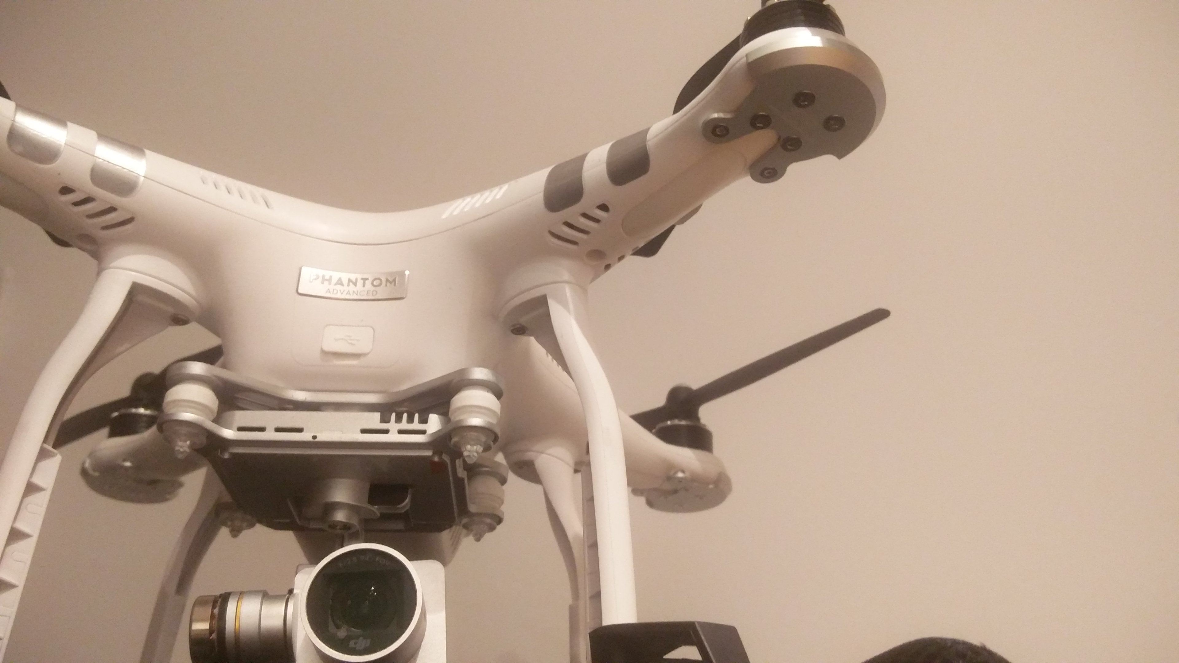

I got the kde motors I the mail today and installed them tonight. It took a good two hours to do it slow and right. I found the hardes part was that I had to dremel out the x support between the motor mount holes so the bottom of the motor could fit, that kinda sucked. Otherwise, was pretty straightforward. Will fly over the next few days and report back.

I found that oiling the kde bearings really helped. They spin buttery smooth now.
Arent they sealed bearings? I wouldn't want to oil them...It will just attract more dirt to gunk them up.
They are sealed bearings, but oil can penetrate them. They aren't marine grade, not waterproof bearings. I'm not worried about dirt to be honest, they are sealed in the bottom of the motor mount. If it gets real dirty in there, i have bigger issues I think.
The reason i did this was that I was having a hard time getting them to initiate and would get motor obstructed errors. I ground enough plastic off that shouldn't be causing it, but i couldn't figure it out. I took them back off and just pondered. I kept spinning them and could feel how roughly they were spinning. It reminded me of something .. I spent alot of time rollerblading, skateboarding and now fixing my kids scooters, where old/rusty bearings felt exactly like that. After a quick oil, those things always, always worked better. So i looked up the bearing type, and its MR84ZZ and MR104ZZ .. which are actually pretty common bearings. Used, not only in RC application but other areas .. like skateboards and rollerblades. So i decided that i would oil the bottom bearings and see what happened.

After a little oil added and re-mounted, i spun each motor 50 or so times. I could feel the bearings oiled up, loosened up and spinning much more freely. That was really nice. It went from a gritty feeling to a smooth feeling. I can actually spin it and it goes on its own. Since then, my motors all start super easily and no issues :)

Hey if it works for you that's all that matters. FWIW when I first dremeled out the motor mounts to fit the KDEs it still didn't feel smooth. I went back and dremeled out this first inner reinforcement on all 4 sides and the motors spun way better with no resistance. I think this is where a lot of people have issues because you could get rid of the X but still feel some resistance.
