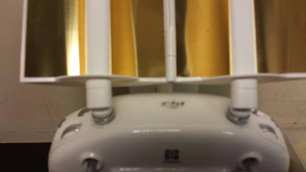

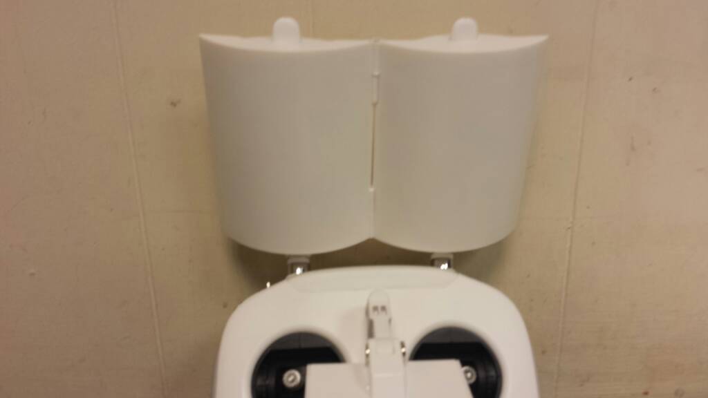

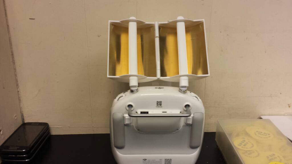

Yeah, you have the same issue as mine.
You'll note the antennas are slightly twisted and the windsurfer sails are bent slightly inwards? This is how to fix it...

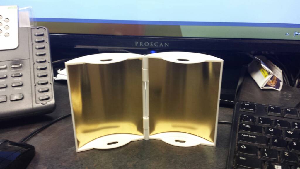

Close the unit like a book, and keep the hinged edge, or spine if you like, down on the desk. Keeping the unit like this on its edge, turn the unit around til you have the wider of the two holes facing you; these are the ones that go down to the bottom of the antennas and they're the ones that need to be widened.
Then, using a round file, start filing downward towards the hinge to increase the width of these larger holes. Keep stopping regularly and check the fit of the windsurfer until it becomes a snug fit on the antennas, and keeps both "sails" perpendicular at 90 degrees.
I had the same model as you too, paid £9 for it from eBay. Same problem, they antenna didn't fit straight so got a refund from the seller and said I could keep the booster. As Numone mentioned, really easy to file down the offending hole to widen to allow a straight fit :)
I've been getting much better range with the booster, very directional so keep pointing at the AC.
