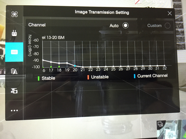

do hack all th chaneel now, and i have up to 30, but my issues that i cannt use the custome bottom?! Is that normal, i am using latest frinwaer and go all.?!!!
So why i cannt use the custome botto
I View attachment 27552do hack all th chaneel now, and i have up to 30, but my issues that i cannt use the custome bottom?! Is that normal, i am using latest frinwaer and go all.?!!!
Here's why

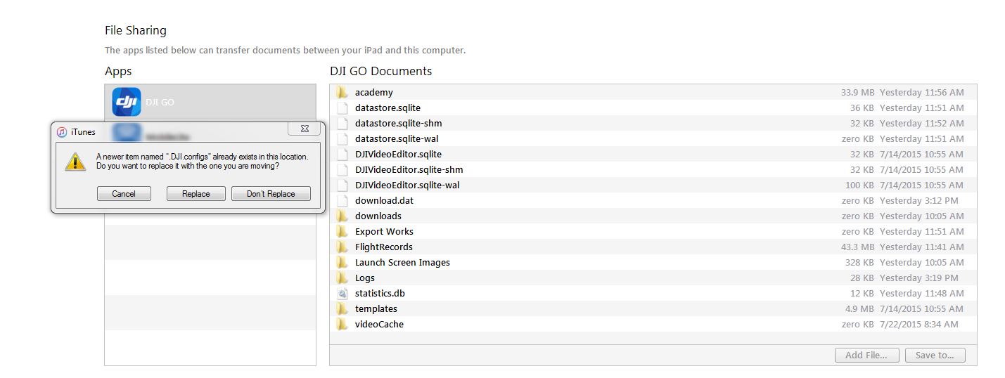

I just installed the config file and now also have all of the channels in 1.3.2 on an Air 2. A couple of notes however.
When I fist clicked on "add file" and selected the new config file, I got a prompt box asking if I want to replace the original file. See the first photo attached below.
I selected replace, and then got a second prompt box about needing to unlock my iPad. See the second photo attached below.
I knew this would happen if the iPad was locked, I just wasn't paying attention to it and didn't see that it had locked.
I unlocked the iPad and saw that I had the GO app open, so I closed it out and again attempted to install the new config file. This time there was no prompt box about replacing the original file.
I am assuming that if you have the app open when you try to install this config file, you will get the prompt about replacing the original.
I disconnected the iPad from iTunes, opened the GO app, and there were all the channels. I haven't flown yet, but I am assuming that if I can see them now that they will be there later when I fly.
